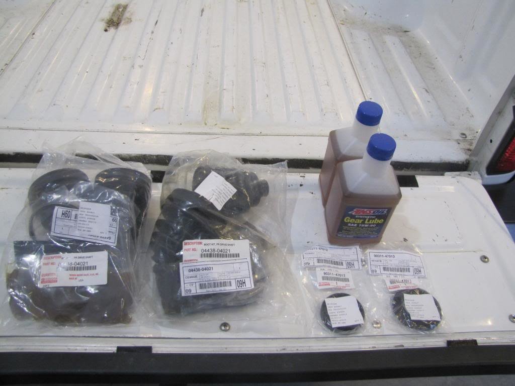

    Parts:
    Toyota Inner and Outer Boot Kit
    P/N: 04438=04021
    Qty: 2
    Price:$31.11 each
    Note:Includes inner & outer boots, CV lube, snap-rings, and boot clamps.
    Toyota Differential Seal (Right)
    P/N: 90311-47013
    Qty: 1
    Price:$12.87
    Toyota Differential Seal (Left)
    P/N: 90311-47012
    Qty: 1
    Price;$7.77
    Differential Gear Lube
    Type:75W-90
    Qty: 1.25qts

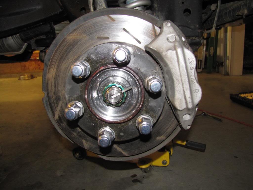

    Remove cotter pin. It may be most effective to use a pair of needle nose pliers to grip head of cotter pin and tap out pliers with a hammer for removal. Slip nut cover off. Use 36mm socket and breaker bar or impact wrench to remove axle nut.

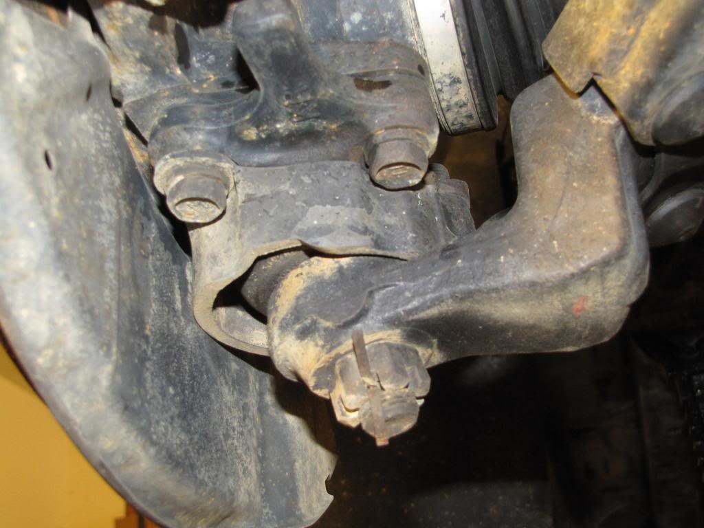

    Remove the four (4) 14mm bolts holding the spindle to thelower control arm (LCA).
    Step 6:
    Remove the sway bar end link with a 6mm hex wrench and a 17mm wrench.

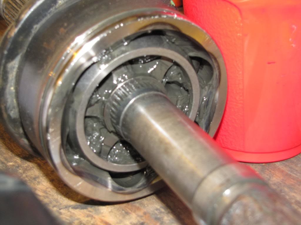

    Proceed to bench vise and clamp axle in vise. Be sure to only clamp on the exposed (when the boots are on) portion of the axle. Do not clamp on any of the unexposed portions of the axle because some parts of theaxle need to be smooth to make a proper seal with the boot. Clamp the axle in the vise with the inboard tulip facing upward.
    This is a good time to mark the top of the inboard tulip and the axle splines to tulip.
    Step 16:
    Using a pair of snap-ring pliers, slide exposed snap-ring down the axle shaft.We will be removing and replacing it later.
    Step 17:
    Place a large socket (25mm works well) on the top of the inboard tulip and gently tap it down until the inner locking spring is exposed. Using a pair of pliers, pull the locking spring out. We will be replacing the locking spring later.
    Step 18:

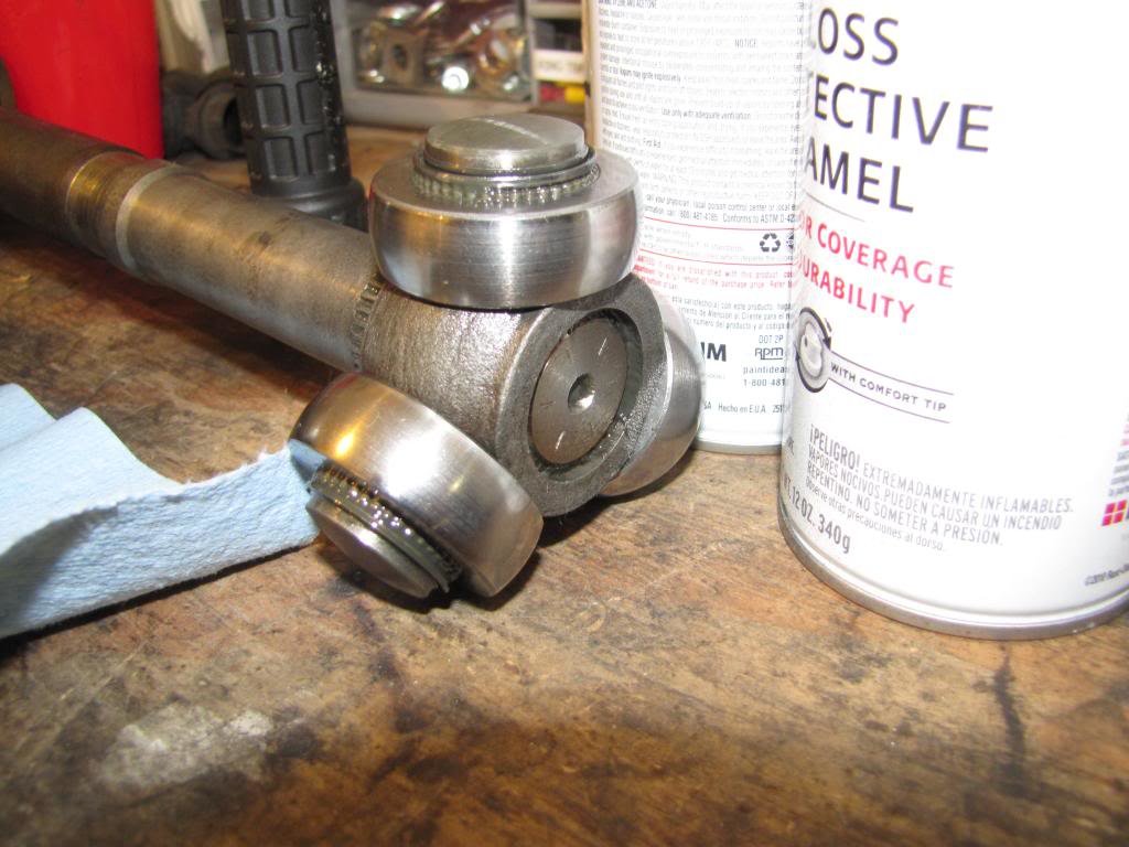

    Using a brass hammer or equivalent, tap inboard tulip up the axle shaft until it comes off.
    Step 19:
    Using snap-ring pliers, remove the lower snap-ring. Take your time and don’t damage the splines. We will be replacing this with a new snap-ring later.
    Now is a good time to take some Scotch-Brite and clean up the axle between the joints. Be sure to wipe all of the debris clean.

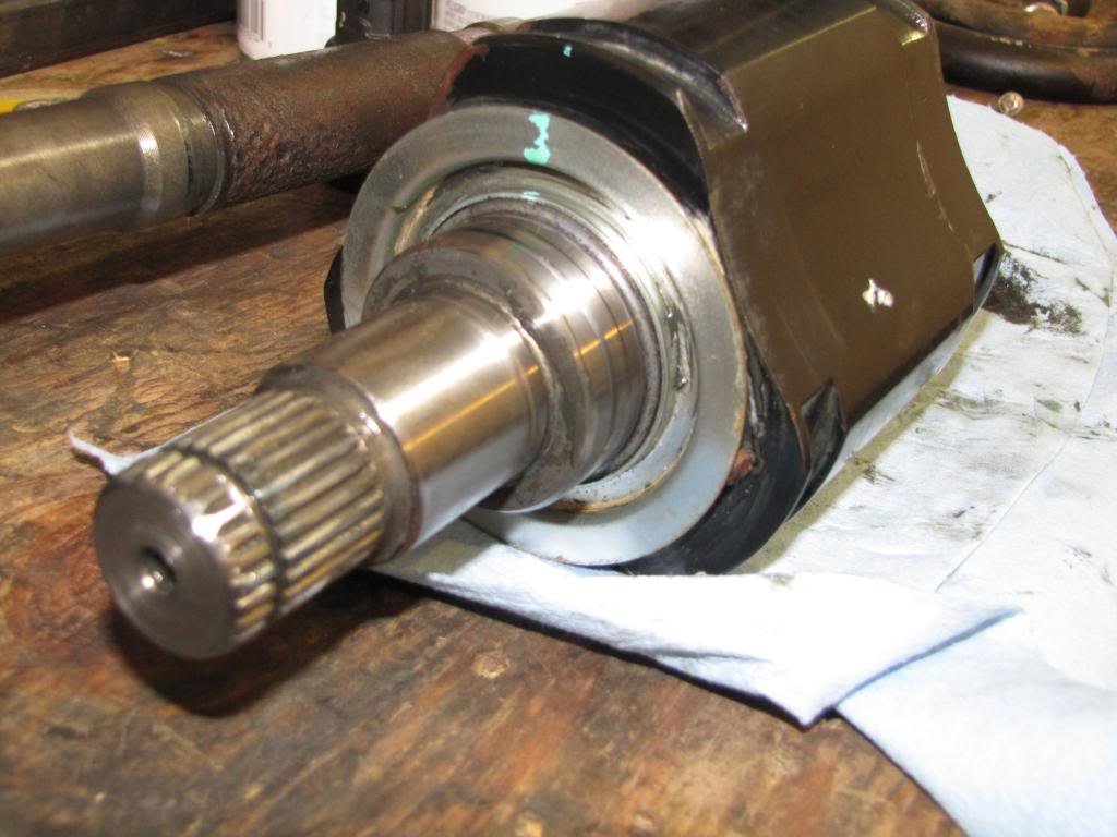

    With axle lying on workbench, using snap-ring pliers remove differential snap-ring from inboard housing spline. Install new snap-ring. Don’t skip this step. I had a very difficult time by trying to re-use the original snap-ring. I highly recommend replacing it. It comes in the Toyota boot kit.
