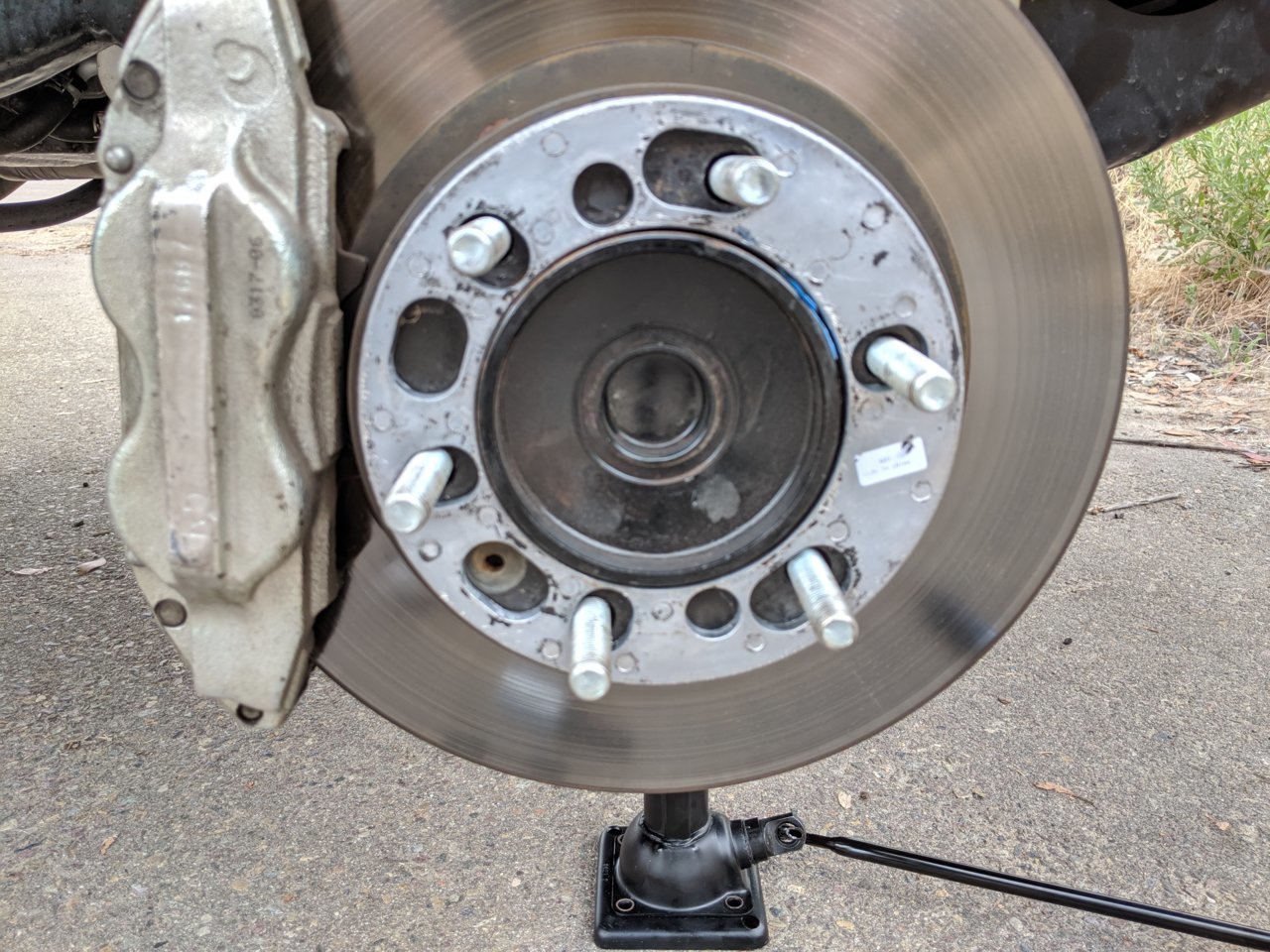

    Step 1
    Install extended wheel studs up front. This is NOT optional for any slip on spacer. Not even a little, not even temporarily, not maybe it will work. If you don't intend to do this, don't read any further because I don't want to be responsible when your wheel passes you on the highway. My wheels' (that don't support extended thread lugs) lugnuts were only engaging about 8mm of the stock studs WITHOUT spacers on a test fit.
    Most guys use the Dorman 610-463, some run ARPs, there are extended sets on Amazon, and I bought a set from wheeladapter.com - https://www.wheeladapter.com/product/extended-wheel-studs-for-toyotas
    There are a million write-ups for installing studs, I did use the Lisle 2288 stud installer and I did love it. Ok so, studs are on.

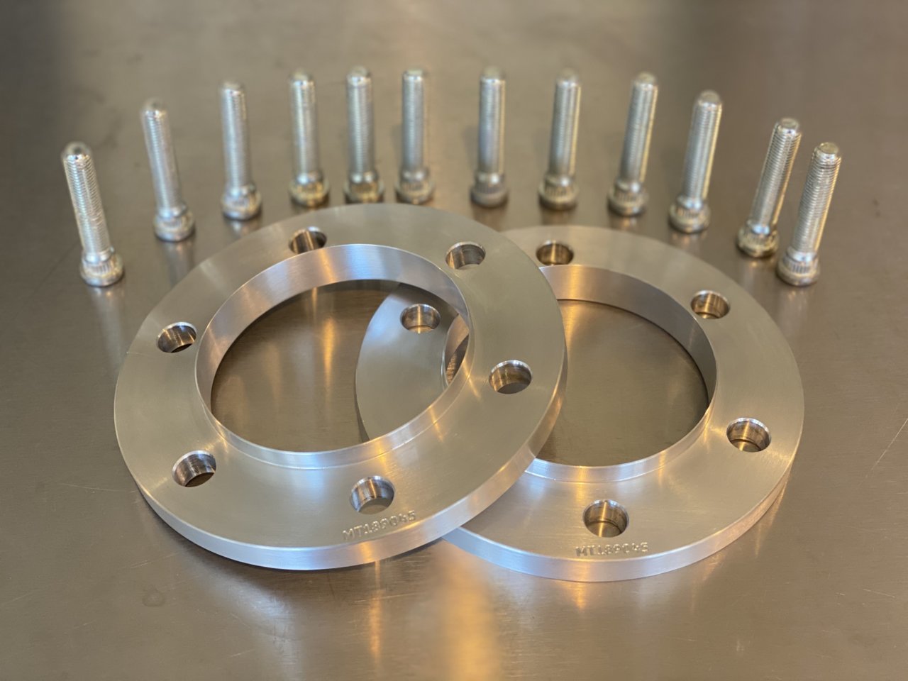

    Step 2
    Get good spacers. I'll be honest and admit that I tried the $5 wheelers 1/4" spacers on their website. They are terrible because they are not hub centric and even after multiple attempts, I could NOT get the wheels centered on the studs only (aka lug centric). This manifests at varying levels of vibration/shimmy in the steering wheel at higher speeds. The 60 degree conical seat lugs are usually pretty good at centering the wheel, but not in this case.
    These are bad m'kay? Cheap and bad. Don't use them. Maybe in a pinch for a few days at most.
    These are the good spacers below. I called into Fred at wheeladapter.com. I can speak for these guys, I have visited their shop in LA, and they use QUALITY steels and aluminum and it's all made and machined in house to spec. They have made me many spacers over the years from steel for a 1 ton chevy to aluminum spacers like others. They made me a custom set of 5mm wheels spacers, 106mm ID for the stock hub bore and 110mm OD hub to match the bore on my aftermarket wheels. I also heard that BORA will custom make spacers to spec too.
    I did pay $160 shipped for 2 custom spacers and had them within a day of ordering. It isn't cheap, but remember, it's a lot cheaper than new wheels by a long shot. They're made to order from a US shop with good materials. They just slipped onto the hubs with tiny taps needed to slide onto the hub. The fitment was perfect.
    The wheels slipped right on snug to the spacers and centered perfectly on the lugs. Here you can see how much stud is left. You may even need extended lugs so they don't bottom out. Mine didn't bottom out, but they're probably within a few mm. Now, I probably have 25mm of lug engagement.
    Wheels are on, and now there's a few mm to spare to the caliper. Success.

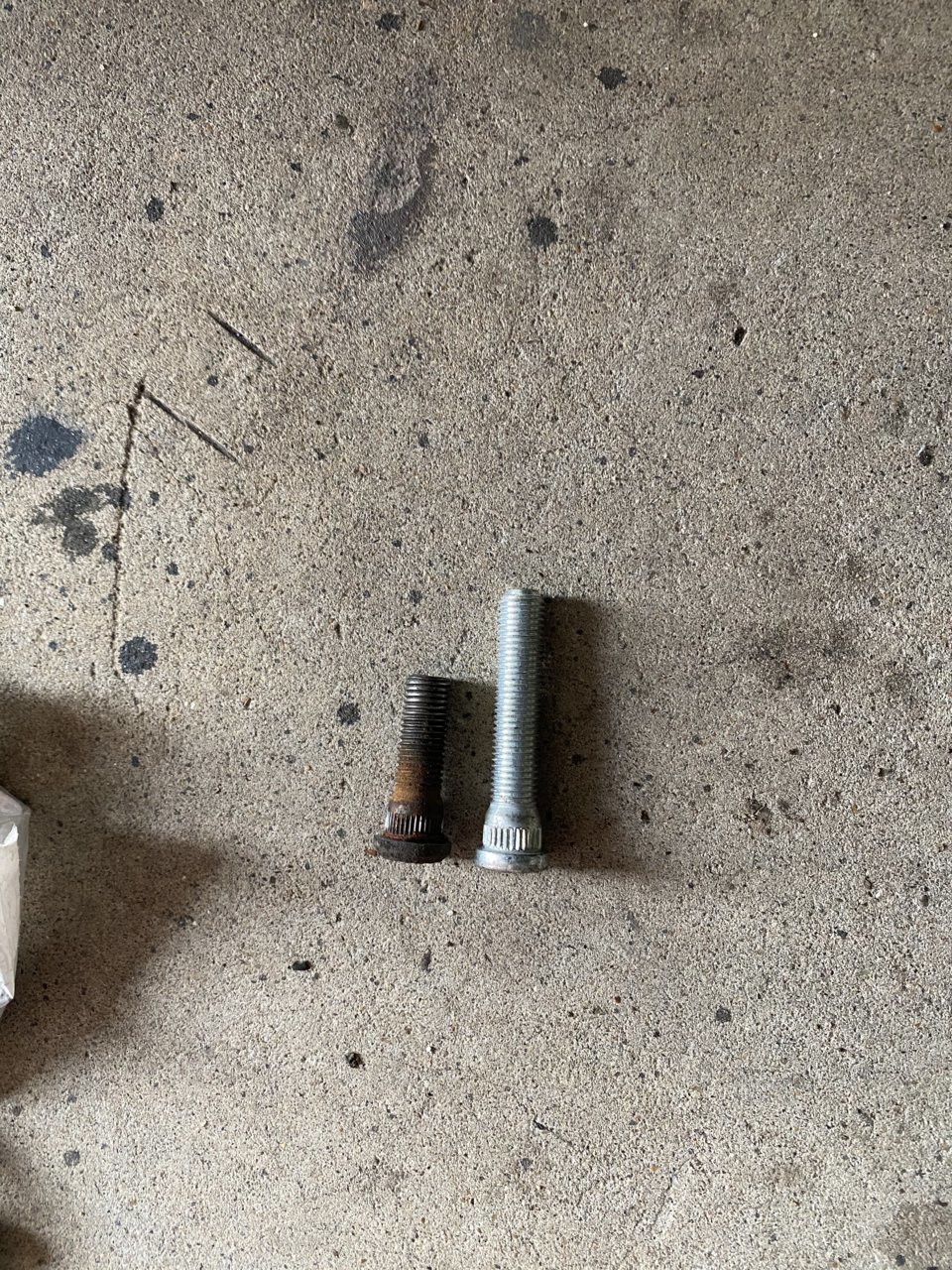

    I’ll be joining this club today. Spacers are from BORA and were $50 each plus $25 shipping. I bought extended studs from wheeladapter.com, linked above and paid $35 shipped for 12. All in, $160 for this setup.
    what’s nice though is these have a 106 inner hub and a 108 outer hub to match my wheels.

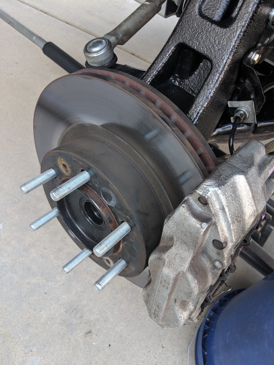

    Barely enough room to add the rear studs without full disassembly but they fit!

    I’m going to order a set of 24 wheel studs from wheeladapter.com as well. On their website it states that their wheel studs are 1/2” longer than OEM but in the picture you posted they seem to be bigger than 1/2”.
    I’m hoping these wheel studs will be long enough to work with my spacers being a hair more than 1/2”. My 4Runner wheels use the shank style lug nut just like all aluminum Tacoma wheels so there should be enough thread engagement.
