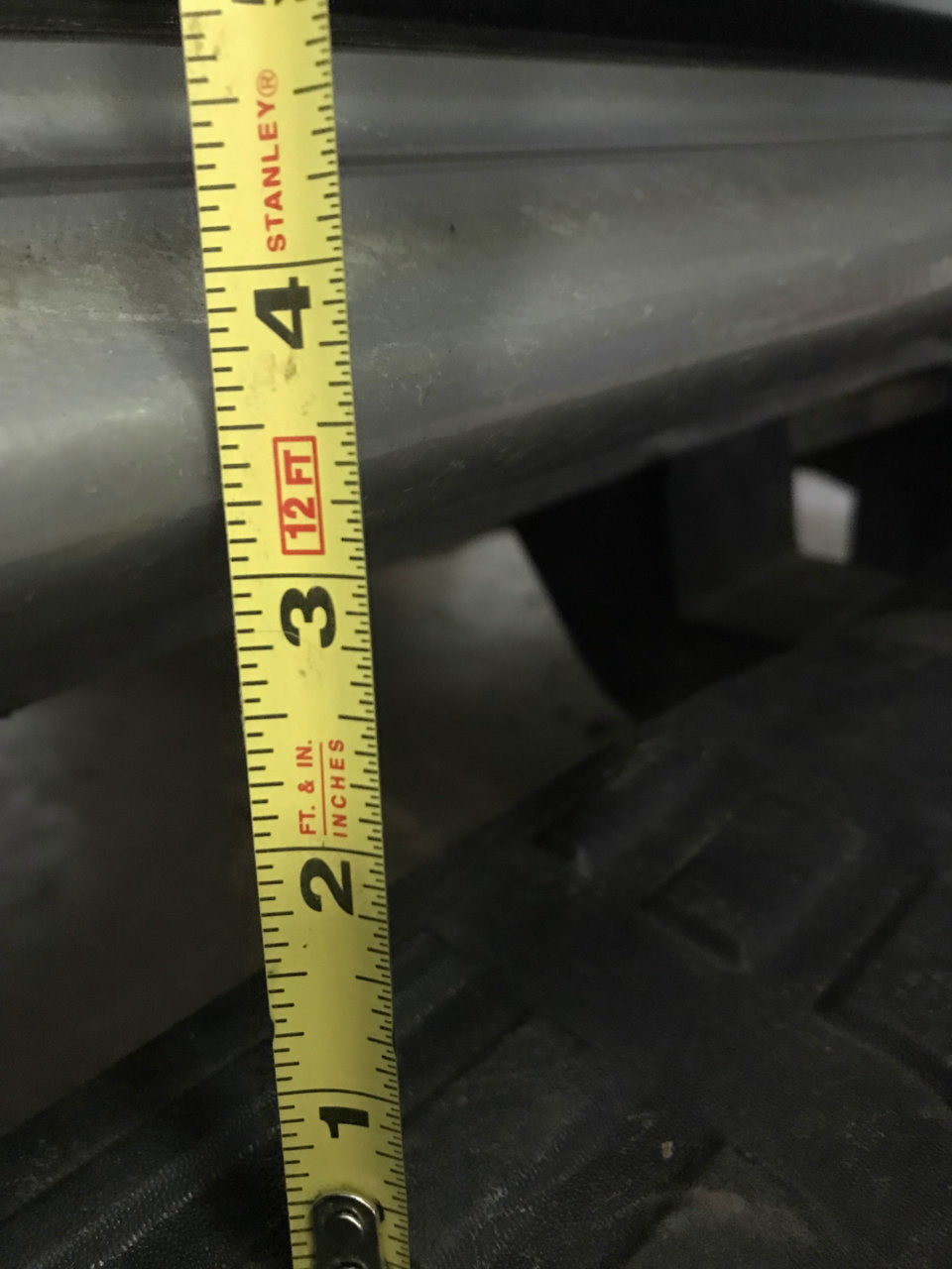

  7. Jan 2, 2023 at 7:17 AM
    scotty117
    scotty117 New Member
    Jan 2, 2023
    #414517
    2019 Tacoma OffRoad
    I had the same problem with my Taco. I used hockey pucks as spacers to lower them 1" (it also moved them out about 1/2"). Wasn't hard to do, took about an hour of my time and very inexpensive. Process was simple. Used a miter saw to cut the appropriate angle on the puck to match the bracket/truck frame, drilled holes in the pucks, had to split pucks for the front bracket to make the correct angle, had to drill a new hole in the front bracket to match the new angle (middle and rear bracket were fine)
    Final result is better but not perfect. I think a 2' spacer would be better but would probably have to refab the brackets for that to work.
    The pics show before/after.EEEAA434-61E3-4632-A329-B1A2B142386C.jpg 81312384-CE0E-4613-98D4-5B845039DA9E.jpg 865FB943-51C2-4419-ADAA-60DECFE228A7.jpg A73F93C9-9964-4691-A9F5-970B97A64021.jpg BDD3EB9C-85C4-4155-96D6-DF6C0CC89B92.jpg 079738BE-885E-4ACF-BD35-76DBEBB4142D.jpg 2
