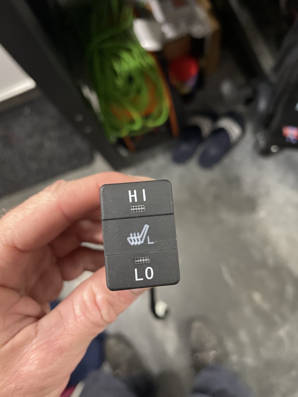

    that would of paid for a base black complete katzkin replacement . If your going to pay that kind of money for seat heater/install then at least demand the Toyota style switches that you can insert into a factory switch hole rather than drill hole randomly near seat. There are at least 2 Toyota sized switches (1 pictured above with a dial and image.jpg). All the aftermarket pads are relatively the same, only difference is in the switches really and brand name slapped on it. I do believe that katzkins had something different with a cool/heat pad though.

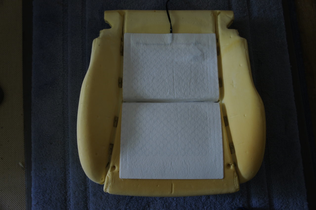

    Spray adhesive wasn’t needed (with provided tape) on the bottoms but was needed on the backs. Seat back has a contour that bulges which looked like ass after the katzkins were installed so I took it all off and sprayed it to lay flat. I still haven’t wired it in yet but I have the harness just about redone and ready for install.

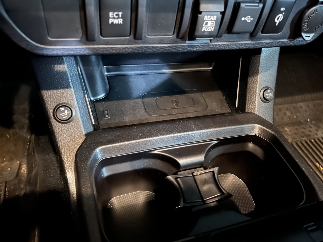

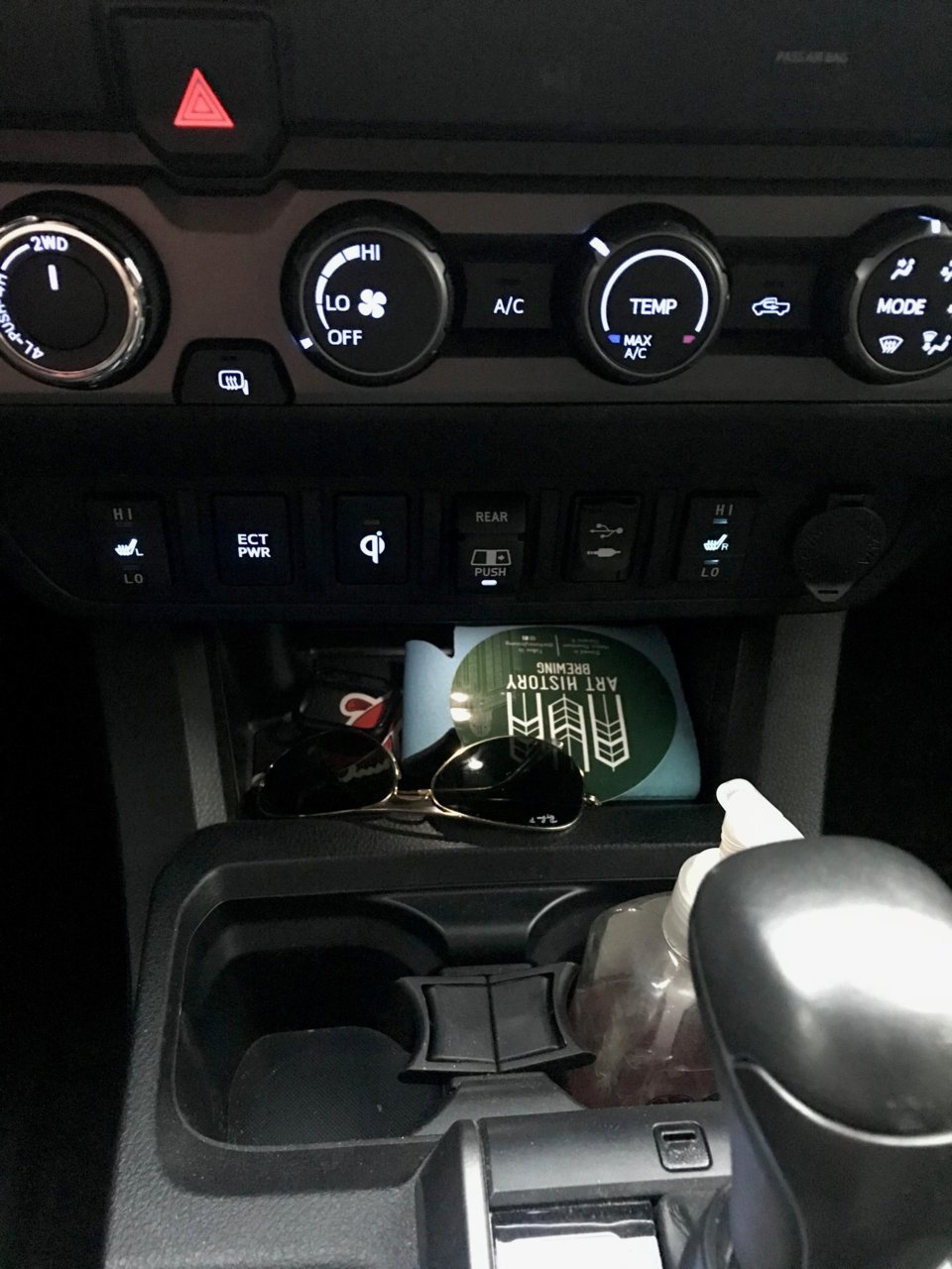

    Here’s what “generic rockers drilled in the dash/console” look like in the wild… if I’d known about the other switch options, I may have gone with these anyway.
    I might have thought twice about doing the work myself if I’d known the parts were only 1/4 of the price I was paying though… oof.

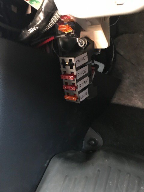

    I added them to my truck. Worst part is taking off the seat cover. If I was doing it again I'd just get some Clazzio leather seat covers and put the heater between the stock fabric and the cover.
    Wiring was easy as I grabbed power from the electronic brake controller circuit. Also have a fused 12v hot for future use.
    Switches I used.
    Donniet53, VaToy and ahoy like this.

    Thats what I did, same switches at the ends of the panel, put the heat pads on top of the org. seats and added Clazzios for that factory look and finisg. $600 for the Clazzios and heated seat kit and had my local stereo shop do the wiring after I installed. That cost me $50.
