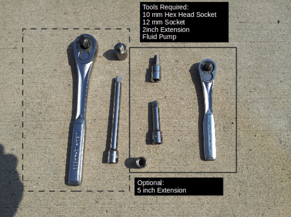

    Tools:
    -10 mm Hex Bit Socket
    -12 mm Socket
    -2 inch Extension
    -5 inch Extension (Optional)
    -Fluid Pump (Optional - work around shown later)
    -Torque Wrench (Optional)

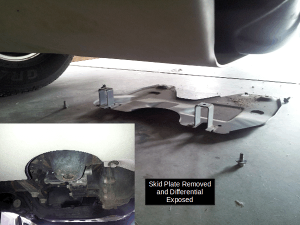

    1. Set the parking brake and make sure you have enough oil and all the tools. This is the area where will be working on today (note the skid plate proximity to drain plug):

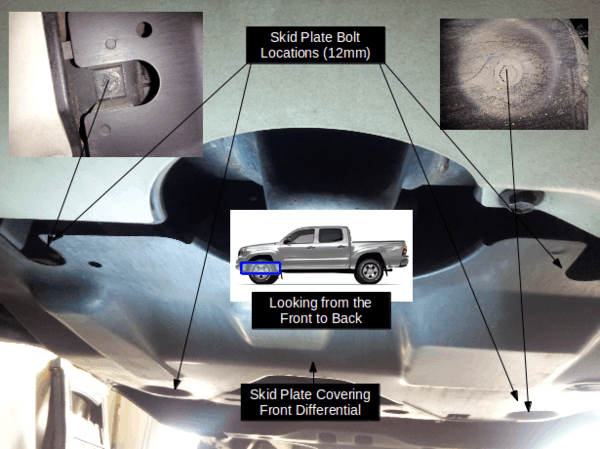

    2. First dis-assembly step is to remove the engine skid/guard plate blocking access to the front differential drain plug. Four 12mm bolts hold this plate to the frame.
    Now with the skid plate removed:

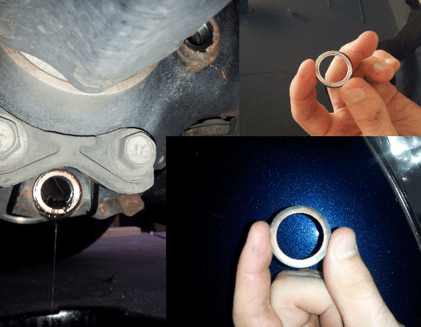

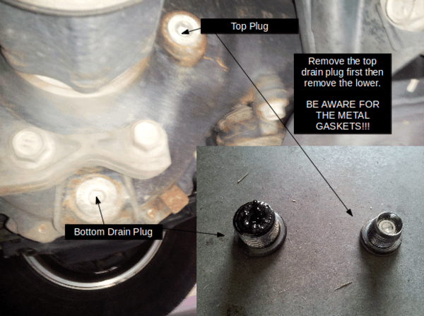

    3. Open the top fill plug first! Always want to make sure that we will be able to fill this thing up. The 10mm Hex Bit should be used here. Then open the drain plug on the bottom with appropriate catch bin. WATCH FOR THE PLUG METALLIC GASKETS! One of them stuck to the differential and one of them came off with the plug.
    I opted to not get new differential plug gaskets. I have some experience with sealing vacuum chambers utilizing sacrificial soft metal gaskets and knife edge ports. Given the limited pressure environment and the condition of the current gaskets, I feel confident they will retain differential fluid without any issues. I examined both gaskets and did notice the fill plug had a distinct grove in it made by the last installation. I flipped this gasket over during installation to expose the flat side to the sealing ridge. For the drain gasket, no ridge was evident so I maintained the orientation of the gasket. These gaskets are important as they are the method for retaining fluid, if the surfaces look smooth and you've had no leakage issues in the past I would keep the current set. Be sure to clean the magnet on the drain plug well before reinstalling.
    Details of the gasket and open differential:
    4. Replace the lower drain plug. I couldn't find a torque specification (someone here probably knows!) so I torqued to match the rear differential (36 ft-lbs) or just really torque it down, we're dealing with a steel case (maybe cast iron???) and steel bolts with a limited clearance for a moment arm!

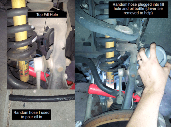

    5. If at this point you realize you forgot to get a fluid pump or your old pump has kicked the bucket you can use the following work around to fill up the differential. If you have a fluid pump, well skip this and fill it up! I removed drivers front wheel to expose the fill plug (pictured below). I had an old fluid hose lying around that actually made it from the fill plug to the front spring from which I could pour the oil into the hose.
    While not recommended, if you do find yourself in the unfortunate spot of no fluid pump, taking off the front drivers wheel grants more access to the fill plug than from below. I also managed to jam the oil jug directly in there, so you don't even need a hose.

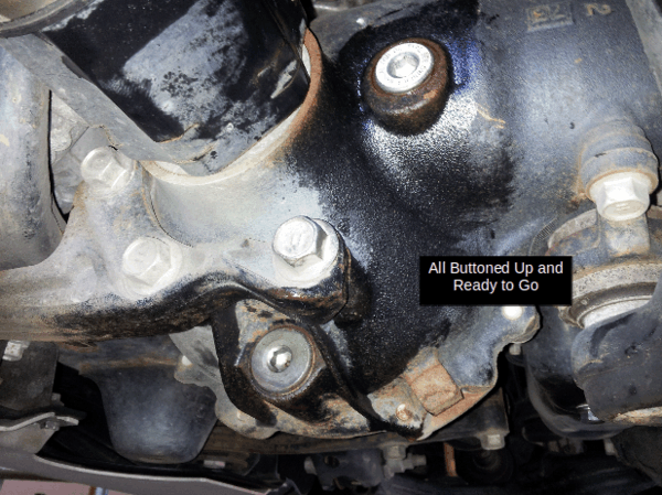

    6. Fill till oil runs out of the fill hole, wait for 20 minutes and top it off (I like to allow some time for the fluid to settle into all the nooks and crannies). Torque down that fill hole and you should be all buttoned up.
