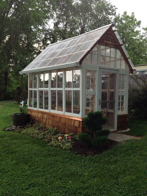

    I'm using old windows to build a greenhouse. The plan is to build a short wall and have the windows sit on top. There will be posts for each corner and 1 on each side of the door, sunk in the ground.
    The wooden frame around each window is 5 inches wide, so when they join at the corner there is this space. I have several ideas on what lumber to use for the corners and how to do it, but it's not experience behind those ideas, just what looks like it will work.
    Since the window frames are 5" wide, I figured I'd use 2x6 for the support posts and the stem wall. The roof is going to be polycarbonate, so there really isn't much weight to support.
    Any thoughts or suggestions?
    This is an example of the short wall with windows on top.
    The greenhouse I'm building will be a shed roof style, like this one.
    These are the windows and door for the front. Stem wall under the side windows. Top 3 windows will be transom and hinge open for ventilation.
    This is what the corner looks like when the windows come together, and where I'm trying to figure out how to locate the corner post and frame the opening.
