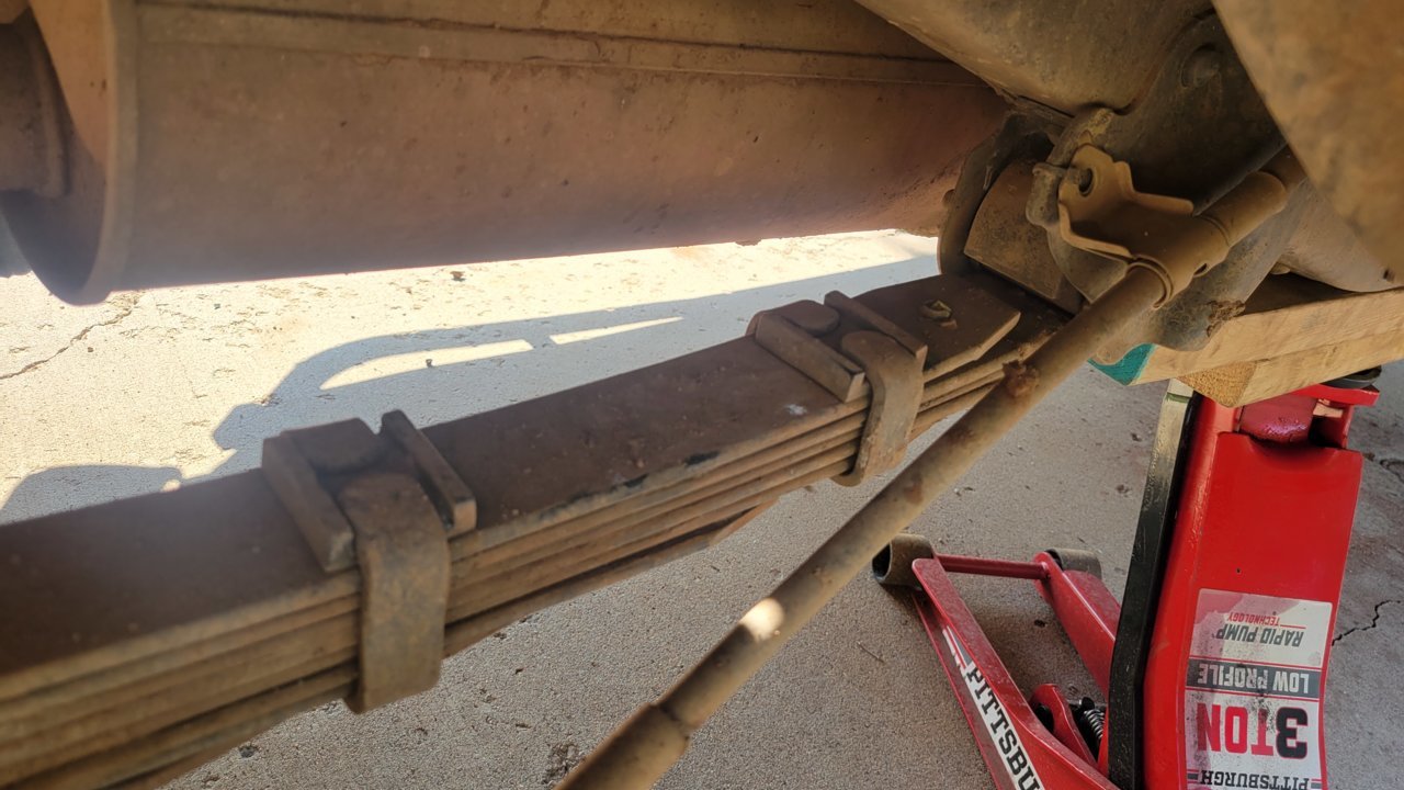

    How do you separate leafs when there's these clamps on it? There's no bolt to remove the clamps

    My stock leafs were not clamped like that, nor are my new Icons. At 5,500mi+, they are silent.
    Unfortunately, you're kinda screwed with that setup. Are those Deavers? Looks like eight leafs?
    Maybe try the cab mounts?

    Icon RXTs for reference:
    Stock leafs were like this, with the keepers not wrapped closed:

    Yea, some day I'll replace these with a quality leaf pack. This is what I get for trying to save a few hundred bucks... The icons look quite a bit nicer. I appreciate all the help! Will keep you guys posted with what I figure out.
