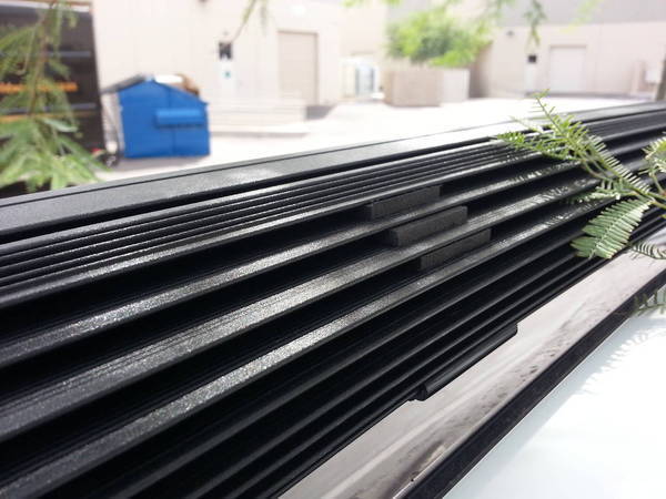

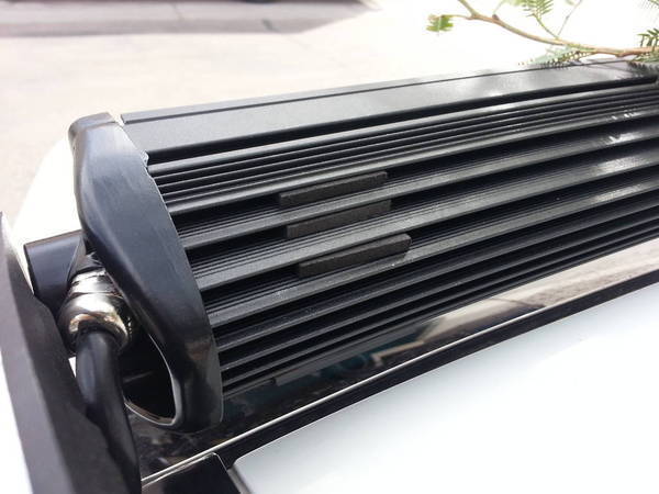

    sub'd, just installed my 50 radius and got the same crazy whistle..going to try the masking tape the lower fins and go for a spin to auto zone for some trimming pieces...Whoooot, hope this does it! Thanks TW
    714AD7AF-B1EC-4CE5-B550-D6925C3DAEE1_zps_1a73b5ad1d58e958a380a58c9839c161468d75ce.jpg
  20. Dec 14, 2014 at 8:29 AM
    #20
    little squirt
    little squirt 808 ALLDAY!!
    Aug 7, 2012
    #84293
    2,334
    808 ALLDAY!!
    put test strips on and noise is gone!! Going to get some fillers and put them in the heat sinks to break up the hug open gaps all the way across.
