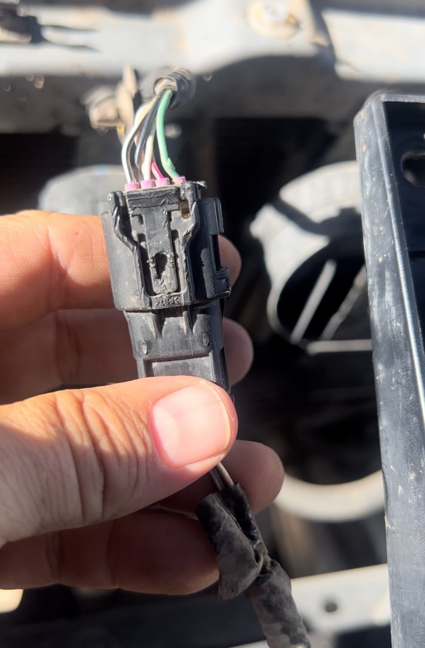

    I cannot for the life of me disconnect the wiring harness for the TSS sensor for my 2019 Tacoma. Can anyone help my dumb a$$ lol?

    I believe if you press around where the hole is in the 1st picture it should let go and pop out. You might need to put a little force on it .

    Try hitting it with some compressed air. Sometimes a little grit can keep it from unlocking.

    Press , push in, after it unleashes pull.

    Stick a small flat blade screwdriver in right where it says “>PRT<“ and pull.

    Push the connectors together as hard as u can. Then push the TOP of the connector, where it’s rectangular, just below the pink weather seals in the first pic, then pull apart.
