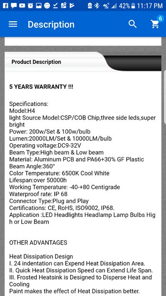

    Bought these cheap led headlights from eBay. They fit and work great. The cleat light is much better than yellowish halogen bulbs and I can see the road so much better when it's raining. They also match the color of my light bar (it bothers me to see two different colors when using my bar.) Only problem is there is no real difference between bight and dim. They are always extremely bright. It really pisses other drivers off. I don't wanna be that asshole on the road. Also I'll eventually run into a cop which will probably lead to a ticket. Does any one know of a way to dim these when using my low beams. I was thinking of building a voltage divider to drop from 12v to ~9v but not sure what resistors I'll need to use or even if that will work with these leds. I'm pretty good with wiring when it comes to relays, switches, ect. but have very littke experience with more complex curcuits. Anyone have any ideas of how to resolve this issue?

    Truck is a 2002. I just bought these because that's what I found. If you know of better led headlights I'm up for suggestions. Didn't wanna spend a lot of $ and get crap leds. The high beams do turn on the top leds for a higher and wider beam but it would also bypass the low beam circuit and would cancel out the voltage divider. Lowering the volts on the leds should dim them by lowering the wattage and they claim and operating voltage between 9-32v. That's why I was thinking 9v
