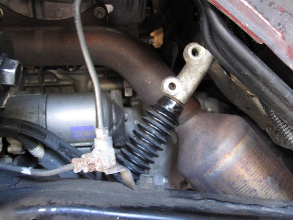

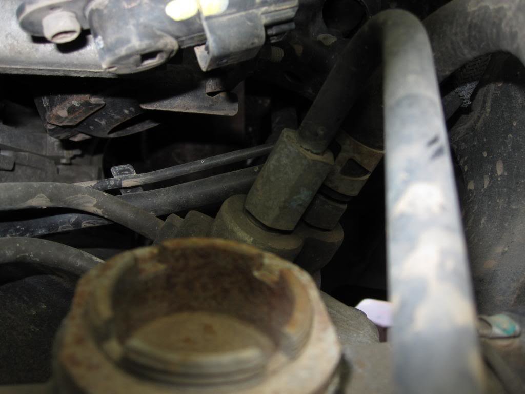

    First question is: when do you need to replace your rack and pinion?
    My thoughts: when your seals are leaking badly enough that the boots on the inner tie rods are constantly wet and you're having to regularly replace power steering fluid in the reservoir.
    Look for this:

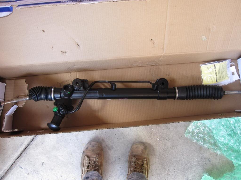

    If you're going to go ahead and jump in to this project, go ahead and order a refurbished rack and pinion unit. I recommend the one from A-1 cardone, part #262629. It will cost you about $300 from rockauto.com after you return your core.
    I do NOT recommend anyone attempt to purchase a rebuild kit with new seals, etc., to rebuild your own rack and pinion. Personally, I think the labor involved with rebuilding a rack and pinion with new seals is more than $300 of my time. And, if you have the tools and knowledge to do it properly, then this thread is not for you.
    Your new unit will look like this:

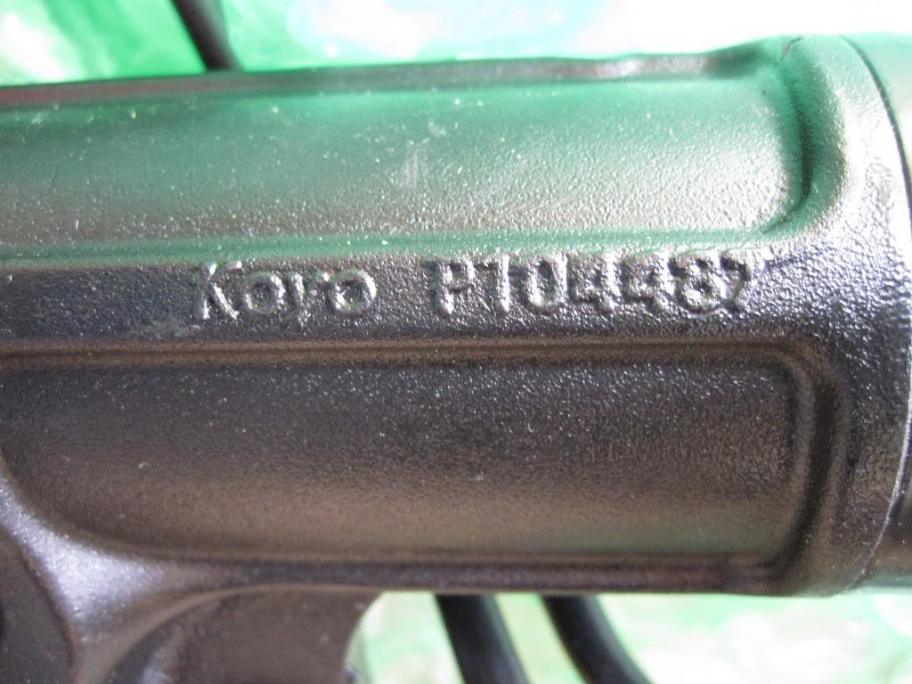

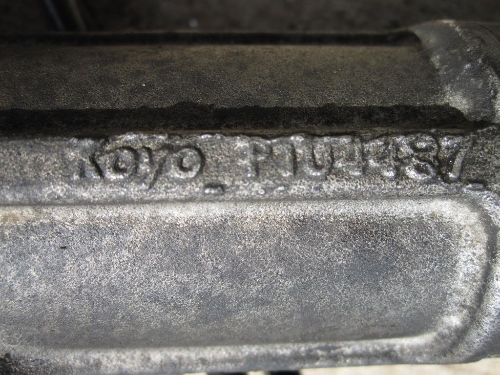

    This is the original core part number on the new unit:
    Exactly the same as the original:

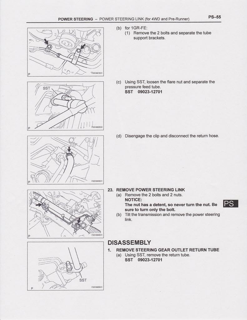

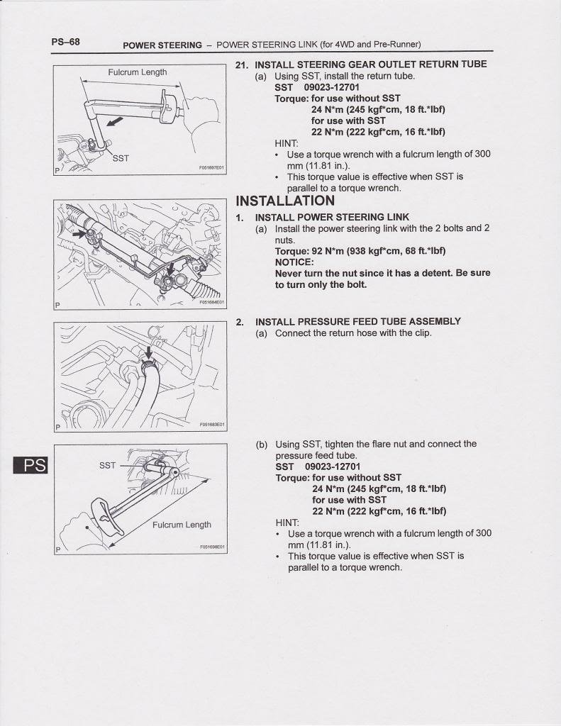

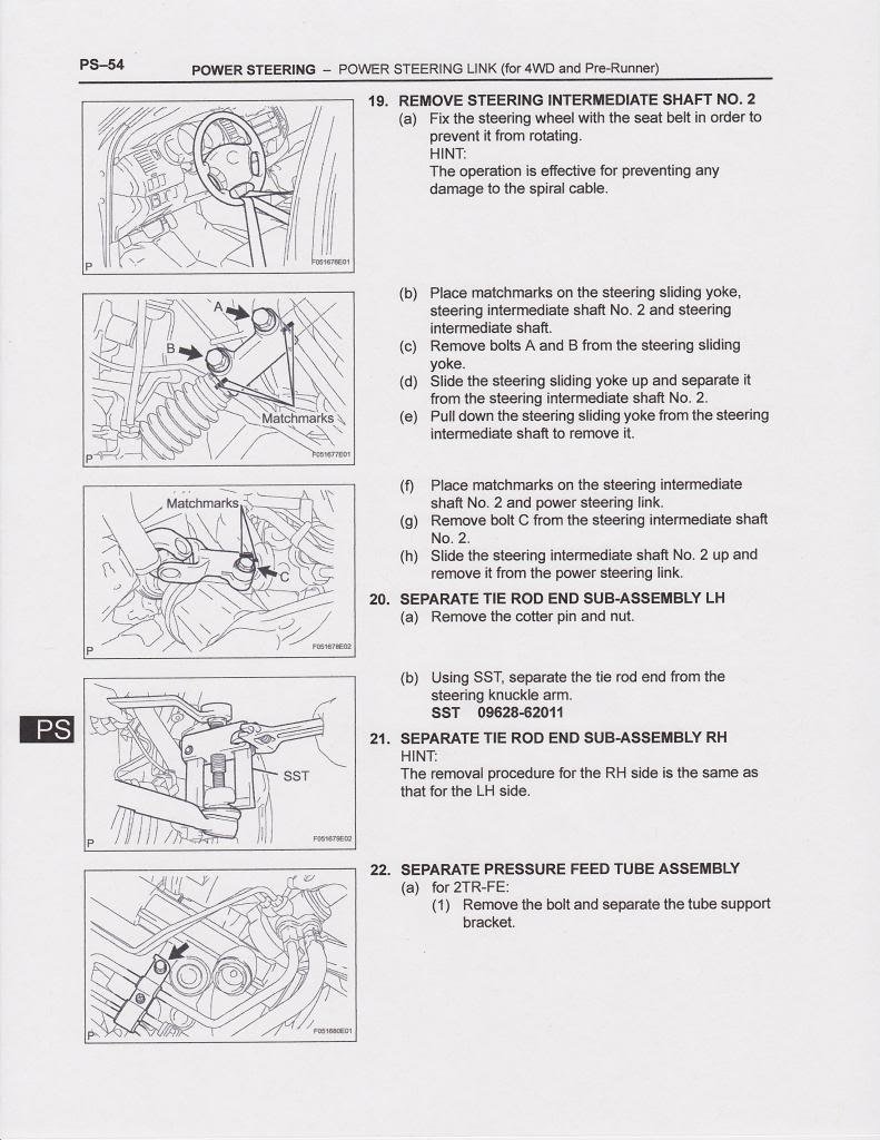

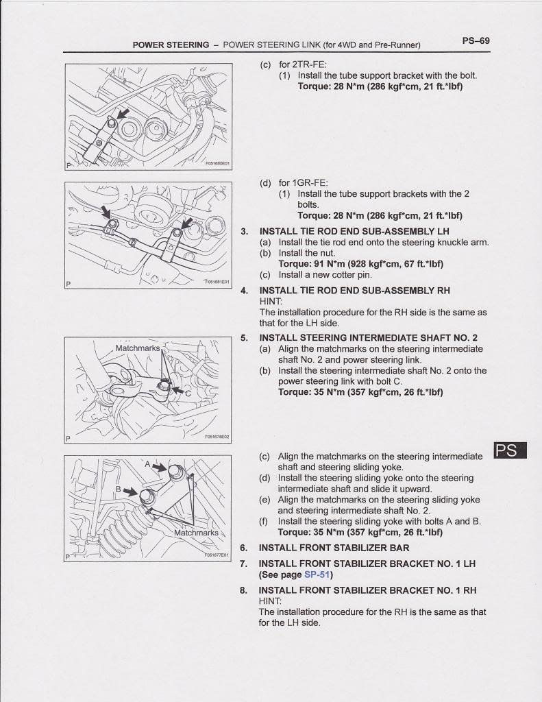

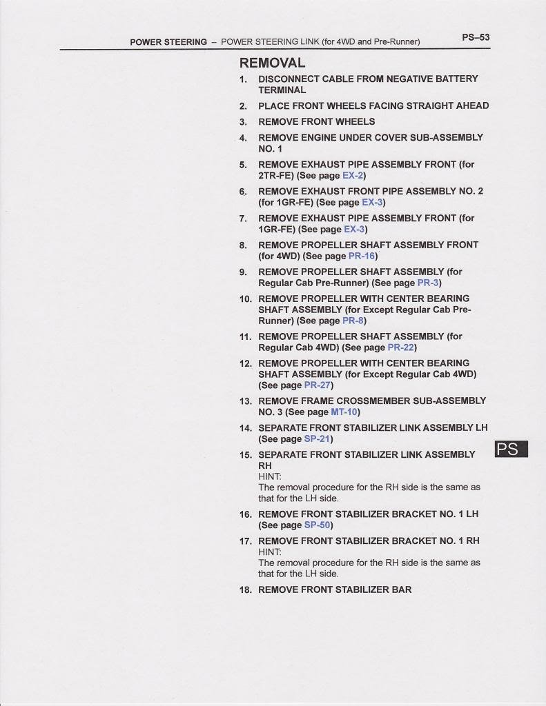

    First, let me show you the relevant steps, per the FSM. Then, I'll add my own pics.
    Disassembly:
    Reassembly:

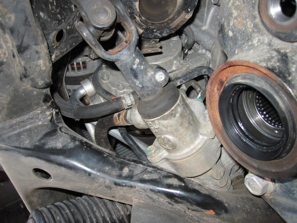

    I had to remove these 2 bolts in order to remove the steering shaft linkage from the rack and pinion unit. Also, you'll need a rubber mallet to whack on the linkage a bit to disconnect it.
    These are the feed and return lines from the power steering pump. Open ended wrench is needed to loosen these and remove them. Maybe a quart of power steering fluid leaked out.
    This pic shows the relationship between the steering linkage, the feed and return lines, and the vent tube from the front differential:
