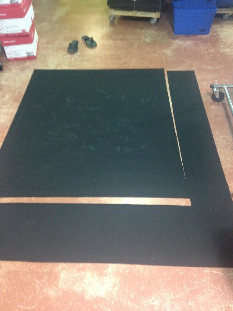

    Picked up the cover. I got 5'x8' of heavy duty marine canvas for $20.
    I measured my bed at 46"x57" of open space from toolbox to tailgate. I made a line at that dimension, then made another line 2" out for the fold.
    Next, I used my shears to cut the pattern.
    Then it was sewing time!

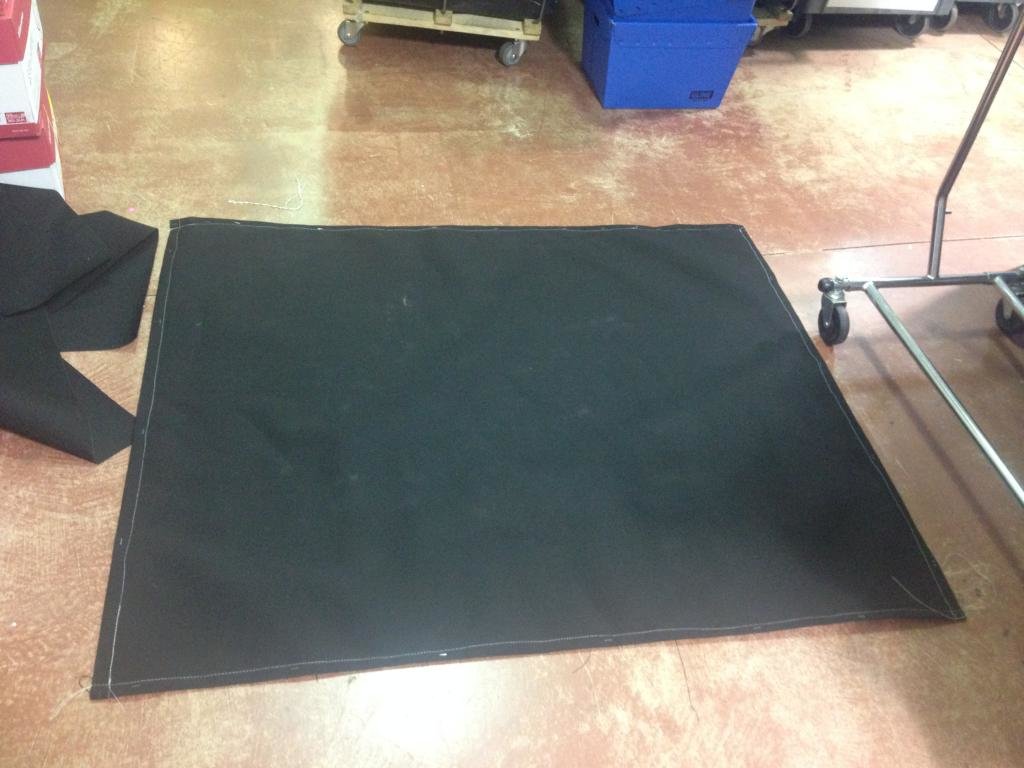

    Then after stiching the lines, it's ready for the buttons. Stay tuned tomorrow for the installation of rivets.

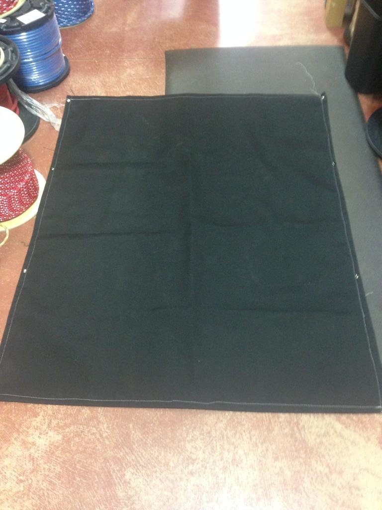

    Got the snaps pressed in this morning. Hope to get the male attachments intot he bed caps this afternoon.

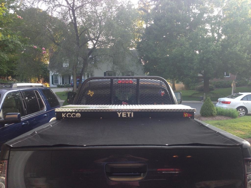

    And the snaps are in! 3CDD3DAC-41D2-49A1-A17E-36975BA7BA06_a836306ab1c508630884f02f67ff95c066454518.jpg

    The corner snaps have not been attached yet because I ran out of snaps...it'll get pulled tight and I'll add some batons for shape.

    Ordered a baton stock to put in for some shape. Should have it tomorrow! It looks great, works well, and keeps the sun off the stuff in the back too!

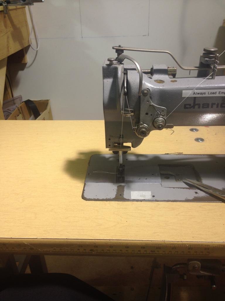

    Wear did you learn how to sew? I can sew by hand, but haven't mastered the sewing machine. I always break the needle. :eek:
  20. Jul 13, 2014 at 1:35 PM
    #20
    ClayCrusher
    ClayCrusher [OP] Texas Transplant Taco
    Oct 9, 2013
    #114143
    858
    Corpus Christi, TX
    13 DCLB MGM
    5100, OME 886 deaver 2" AAL, 1.5" Block Peacemaker deluxe front bumper, 20" led bar, sPOD with custom switches, 285/70/17 Goodyear Wrangler Duratracks, Procomp 7033
    Thanks! Sewing machines are pretty easy to use...especially when they're industrial. I work in a sailing shop, so one of our riggers showed me how to use it, then I just taught myself.
