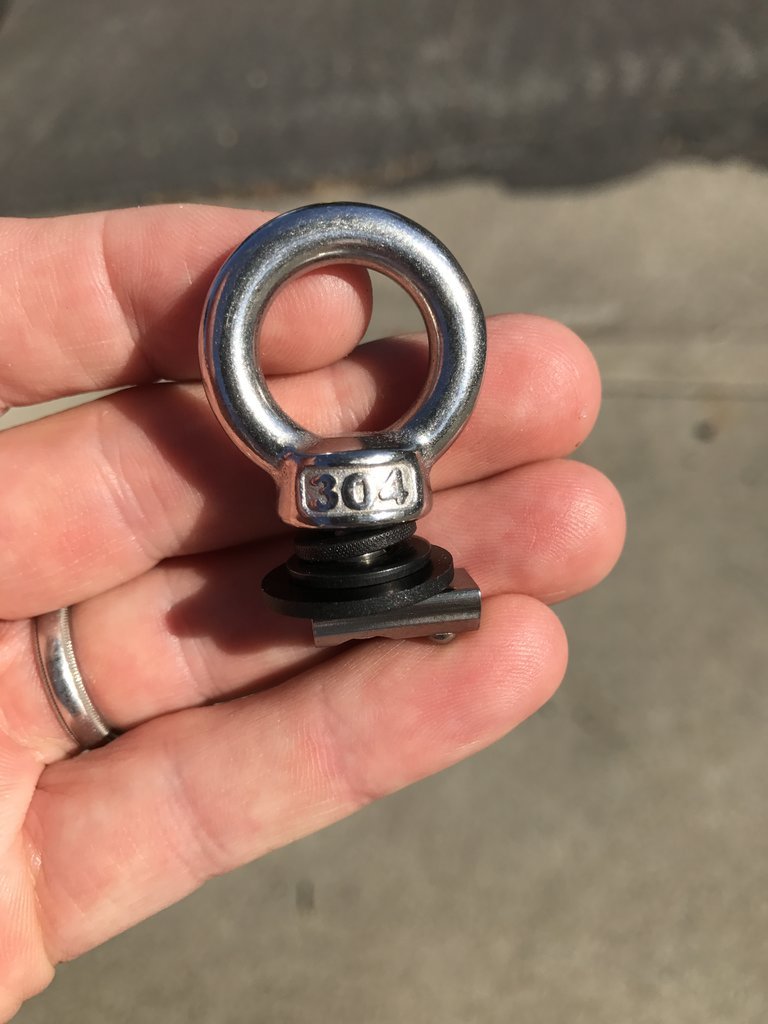

    • First stack the washers on the Eyebolt in the following order: lock washer -> flat metal washer -> Nylon plastic washer

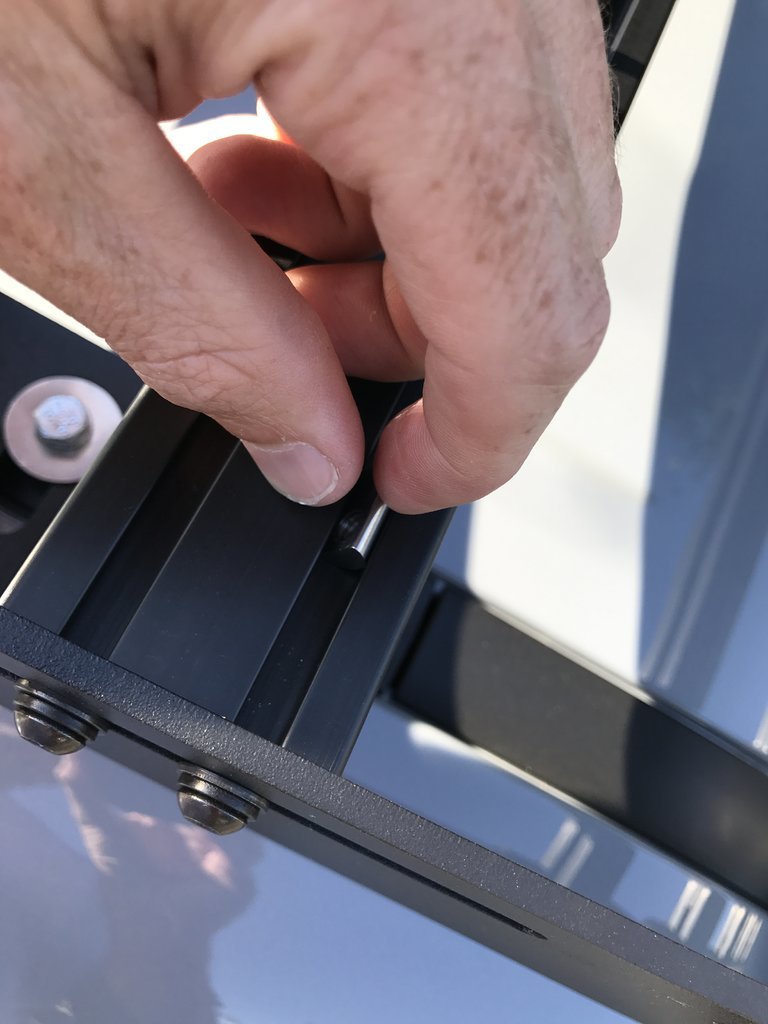

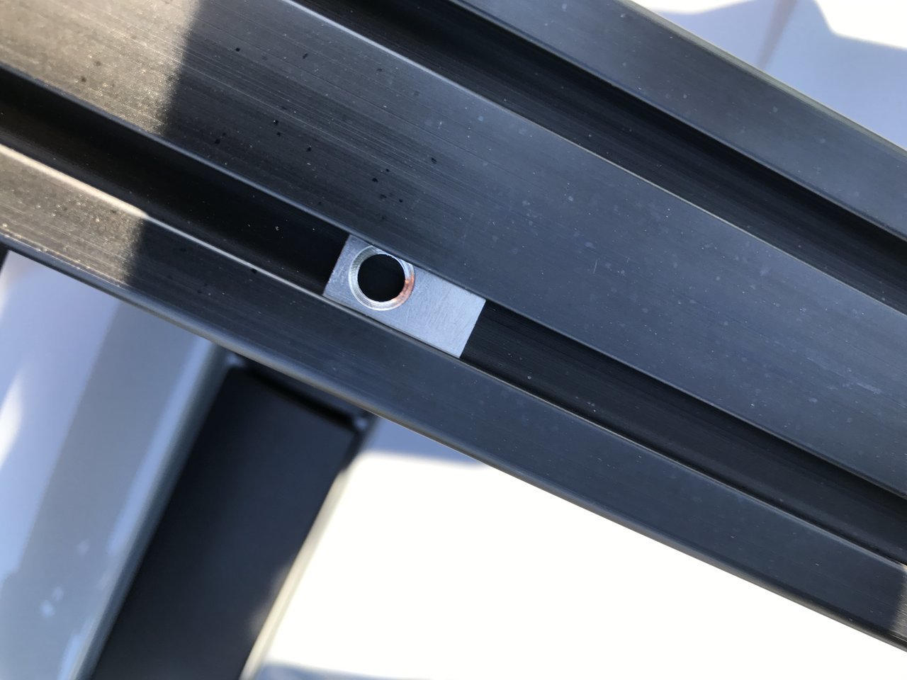

    • Insert the roll-in t-nut into the t-slot and center it up
    • Screw the Eyebolt with washer stack into the roll-in t-nut
    To remove you simply:
    • unscrew and remove the eyebolt
    • flick the roll in t-nut to one side and then lift out. If you have large fingers you may need needle nose pliers or a flat head screw driver to assist.
    And now for the video demonstration:
    As you'll see you and can image, these roll-in t-nuts can be used for a lot of different applications. One thing to keep in mind is that you will need to get a precise bolt length for whatever application you are using so not to bottom out the bolt on the t-slot when tightening.

    I also want to point out that you can leave the roll-in t-nuts in the t-slot without any bolts in them if you wish since the ball spring keep them in place quite well.
