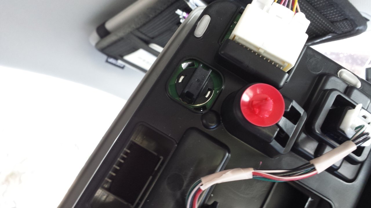

    I've seen where folks remove the Map Light Lens, and then try using tape or other means to try to get the bulbs out.
    There IS an easier way! No tools required. You can do it with your bare hands in just a few seconds.
    The entire Map Light Console simply snaps into place. To remove it, simply get hold of the edges with your fingertips and pull down on it until it comes unsnapped.
    On the back side you'll see the snaps and the bulb sockets.
    Twist the socket(s) CCW about 1/8 turn to remove the socket and bulb(s).
    Replace the bulb(s) in the socket(s).
    After replacing the bulb(s) and socket(s), snap the console back into place.
    It's so easy . . . A cave man could do it. :cool:

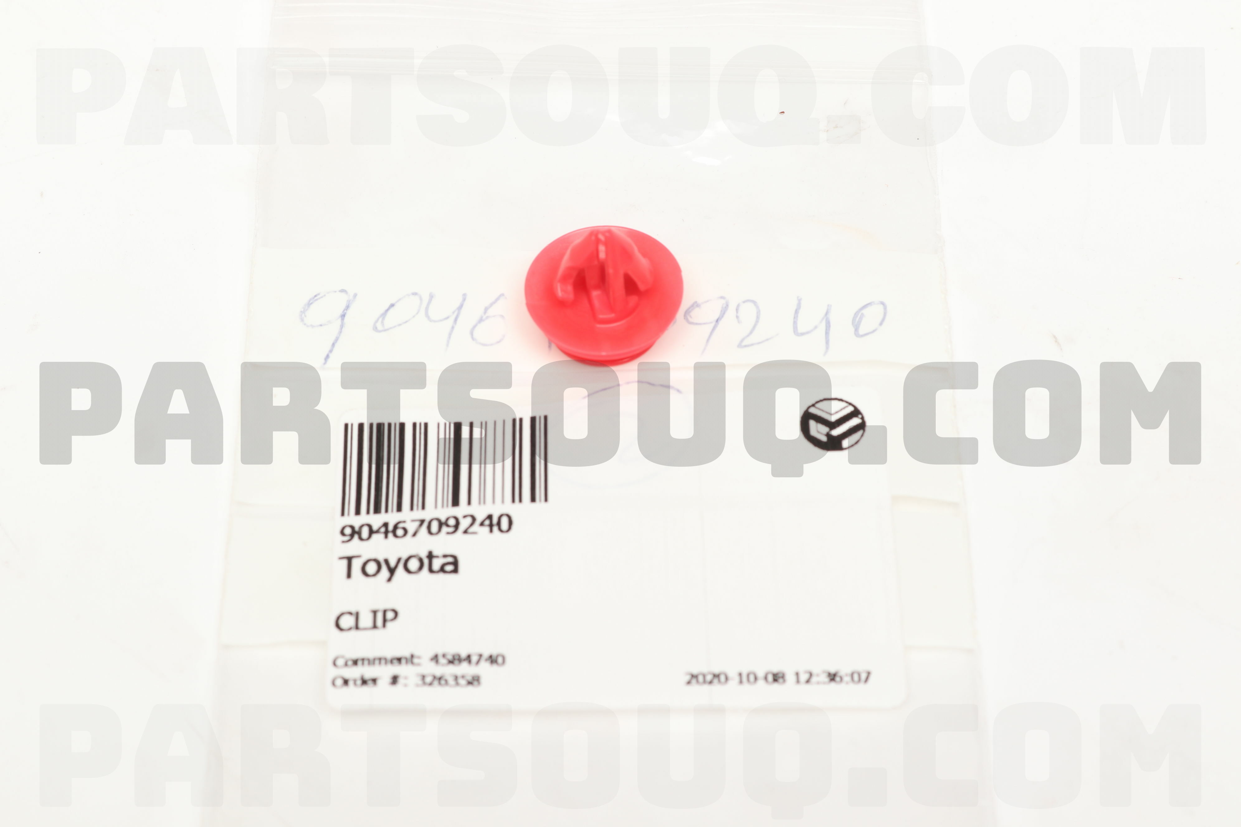

    Mini but related thread jack.... Does anyone know the part number to the red clips that hold the map light console into the body?? I live over an hour from the nearest dealer and the guy on the phone was the opposite of helpful. When I bought my truck used it came with 2 of them broken

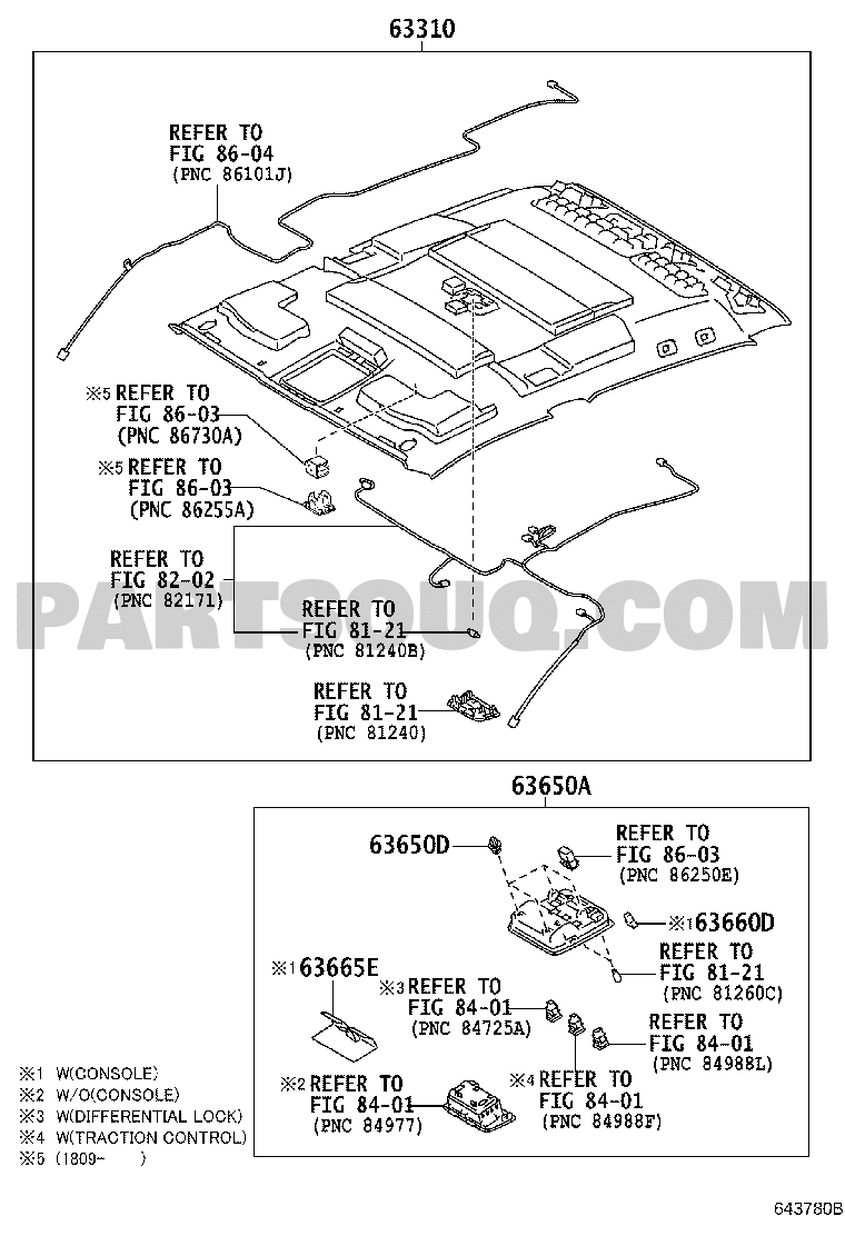

    Are you talking about these? It should be part number 63650D.

    Indeed. Thank you very much.
