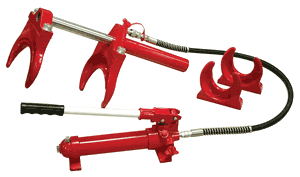

    I don't think they carry this one any more.
