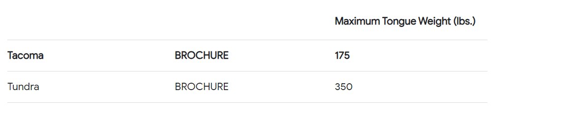

    1. When I search the Max tongue weight for a 2020 Tacoma the search results say 175lbs?
    That seems really low. I understand that the tongue weight should be approx. 9-11% of the GVWR of the Trailer So if my trailer is weighting in NET at 3k that 9% is 270lbs. almost 100lbs over the search result. Is this accurate?

    MOST hitches are rated for 500 lbs without a Weight Distribution Hitch. Can go over 1000 with one but your Tacoma won't handle anywhere near that. I don't know where you are getting 175 lbs, that is way too low. You couldn't pull an empty utility trailer with 175 lbs of tongue weight.

    @Marshall R gave a good description of what you need to known about towing anything with a Tacoma. What I’d like to know is where you got the tongue weight numbers for Tacoma and Tundra. What you have is definitely not correct.

    I was searching the web. I am attaching the full page. I appreciate everyone's responses. This seemed a little odd to me too.

    Yeah that looks very wrong
