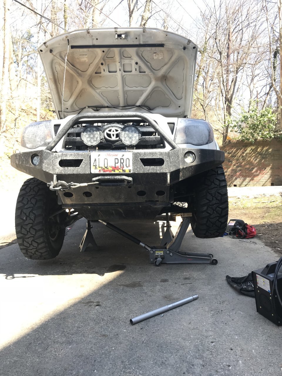

    Quite a bit of trimming to the fenders. about 2in on both the flare and fender. Big CMC and tons of pounding/massaging to the wheel wells and I still scrub at full bump. I got tired of dealing with it so I hope it clears itself someday after a good few hits
