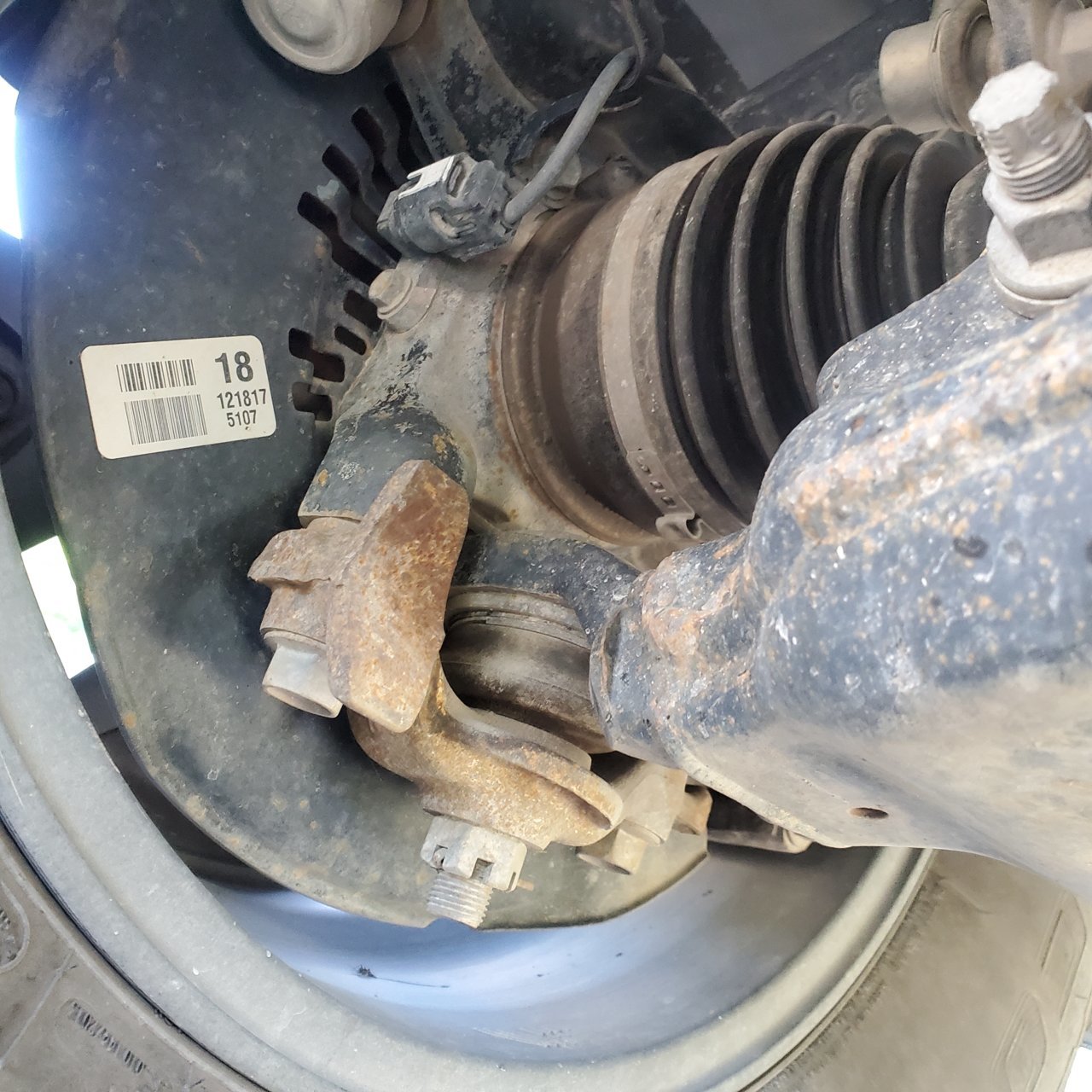

    Havent ever had a new vehicle til I got this truck in 2018, so I'm not sure how much is too much, for a 3 year old vehicle. Got under the truck today to install some LCA skids, and noticed some distinct rust all over. Nothing rusted through, but the black underbody coat is peeling in small spots all over the place, and the exhaust tubing is very brown. I'd had a fresh rustproofing coat on my to-purchade/have-done list for the coming year, wondering if I need to get it dealt with sooner than later. Spent the first 2 years in dry west TX, and the past year in Western VA. away from the coast but definitely had some salt on the roads this past winter.

    All normal surface rust.

    That's all looking normal, some parts are bare metal from the factory and they rust immediately. Clean, sand, prime, paint if you really want it to stay perfect. Or, spray it with Fluid Film and it will slow it down. I'm in Maryland with a 2016 that looks similar. Fluid film every fall before salt season.

    Looks normal with very slight surface rust similar to my 2018. You and I both should start fluid filming yearly.

    Yeah normal. My Arizona truck looks like that. I'd recommend cosmoline over fluid film. But it's personal preference

    Yes id say thats within the realm of whats "normal". However my 16' doesnt have 10% of that amount of surface rust.

    At your frames condition I wouldn’t even consider a rust converter.
