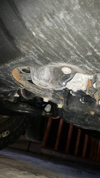

    That picture is all kinds of wrong, this is how people get hurt and wreck things by bad info!
    The proper way to jack up your truck with a hydraulic floor jack is to put the jack under the center of the rear axle housing (the round part) and lift the rear tires off the ground, now put a jack stand under the housing just inside the lower shock mounts on both sides so when resting on the stands the rear tires are just off the ground, now moving to the front you'll find a hole in the skid plate between the tires thats about 3 or 4 in in dia. thats where the jack goes to jack the front up (if you look into the hole you'll see a u-shaped piece of frame that the jack foot will hit) when jacking the front up it probally won't raise even (mine never has) but you'll be able to get the front tires off the ground. Rotate how ever you want.

    If you go buy a good service jack then you can't hurt yourself jacking up the truck because you are never under the truck at any point. It's pretty easy to push the stands under too so you are safe, and remember to cross chock the truck at your first lifting point. If you decide to go under the truck to set the stands, a good service jack set properly will be more stable than the bottle jack pictured earlier.
    You can hurt the truck of course if you jack on something that can't support the weight.
    A good service jack, or floor jack, is the first thing anyone should buy before working underneath a vehicle along with good jack stands of course. Buy 3 ton stands and a 3 ton jack, a 2 ton rated jack or stands is pushing it with a Tacoma or any other truck. You can hurt the truck of course if you jack on something that can't support the weight.
    For jacking points the owners manual is ALWAYS right. That's where Toyota wants you to lift from, so lift from there.

    Correct. This is front lifting point of the truck. Sticks out from the skid plate.
