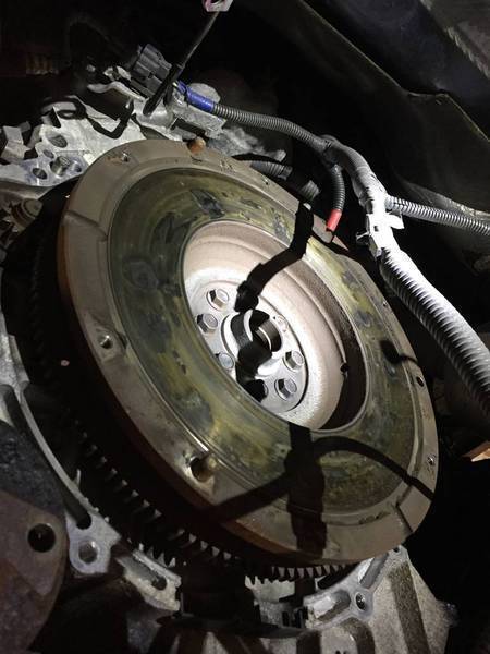

    Dealer says I have 1/32nd left on the clutch. Flywheel has to be replaced as well. Sent a picture of the flywheel (below). Very good dealership. Additional $600 for the flywheel. Total now is $1800 - Ouch.
    I believe the clutch wear based on the flywheel. I guess I better stop smoking the clutch. Tow a trailer and have an 800lb camper on as well.
    Driving a Highlander. Very nice minivan.

    Clutch replaced. Seems better than new. Always used to catch high and quick. Now it catches 1/3 up and longer.
    Dealer (Bobby Rahal) did a very good job. Had to rebuild the hydraulic due to rust at the junction box. All new gaskets, springs, bolts at the joints in the exhaust.
    $1800 out the door - including flywheel replacement.
