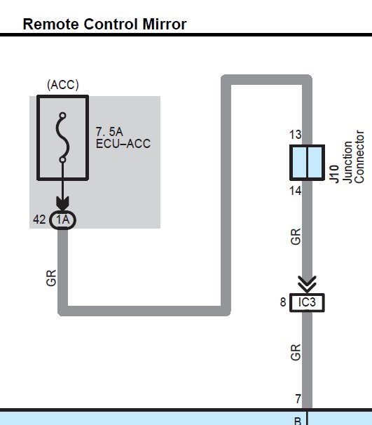

    Seems to be only one fuse. See schematic.

    one fuse to rule them both...:burp:

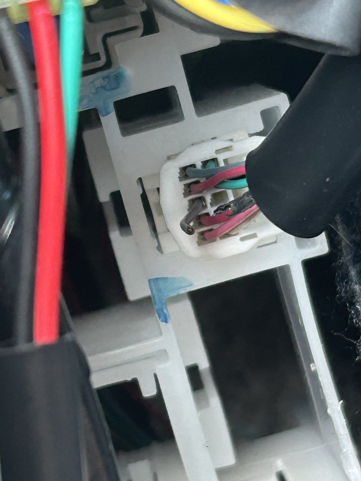

    update

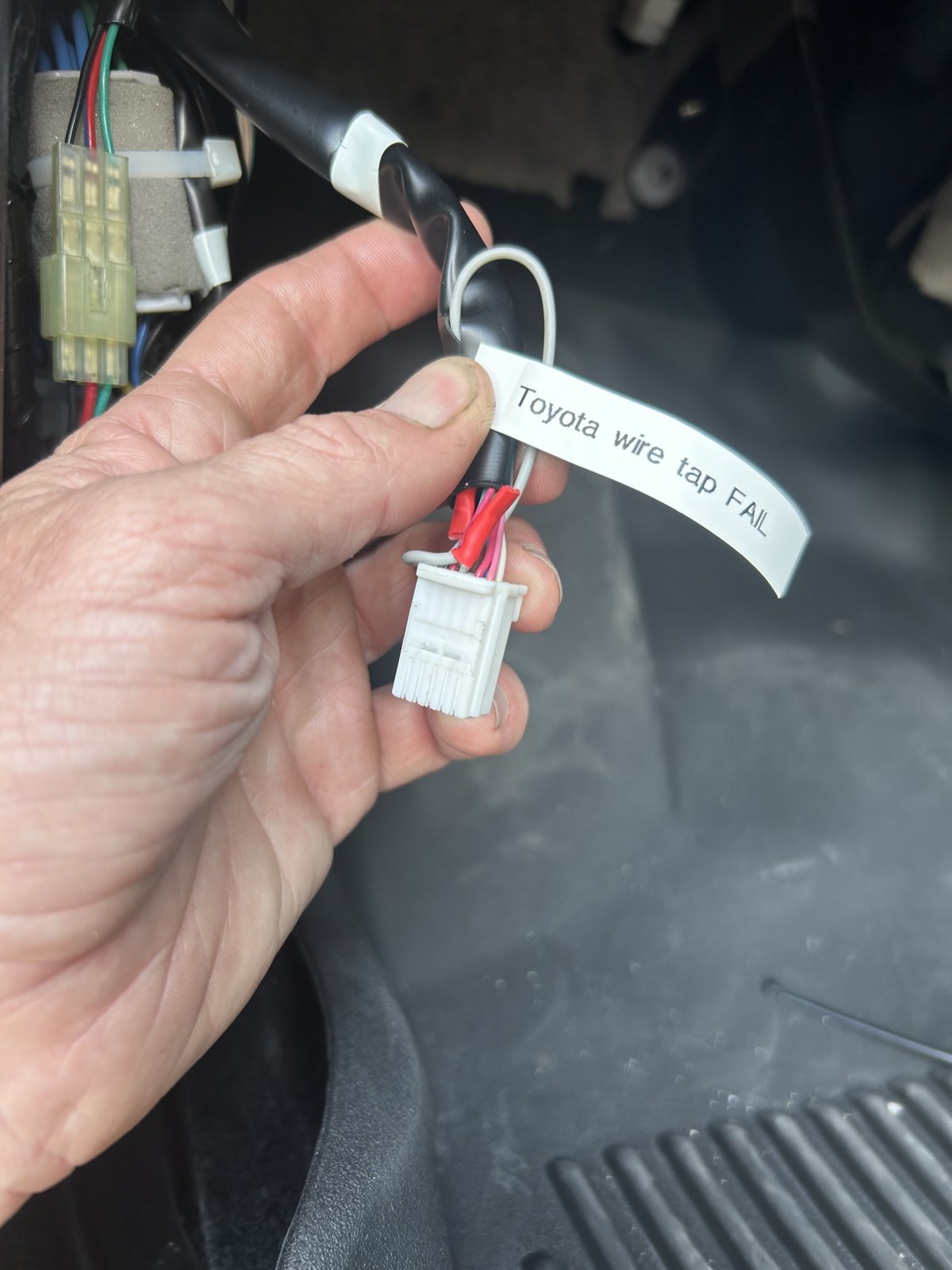

    since the most recent upgrade I did was the gbs, I inspected the 2 main connectors from that- fully seated and every wire is locked in the connector… that’s when I seen it
    the 10p connector below had a broken wire. Looking at it closer showed a black glob attached. After I seen that I realized this was Toyotas wire tap from the led fog light/driving light combo “upgrade”. It’s technically a port upgrade I think. So when I took that out completely so many years ago and there were 2-3 wire taps from it- I put liquid tape to cover the vampire marks, this was 1 of them.
    I would rather depin that wire and make 1 connection but I couldn’t figure out the release on this connector and was getting frustrated so this quick solder job will do for now and I left a reminder for future awareness. This fixed my side mirrors, switch now has power and both can fully adjust again.
