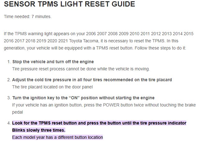

    Try this

    RESETTING YOUR TOYOTA TIRE PRESSURE LIGHT
    Once you properly inflate your tires, your Toyota Corolla or Toyota RAV4 Tire Pressure Light should automatically shut off, but if it remains on, here are few more things you can do to reset your Tire Pressure Monitoring System:
    • Drive at or above 50 mph to reset the sensor for 10 minutes. This can cause your sensor to reset the next time you turn on the car.
    • With the vehicle off, turn the key to the “On” position, but don’t start the car. Hold the TPMS reset button until the tire pressure light blinks three times, then release it. Start the car and wait 20 minutes for the sensor to refresh. The tire pressure monitor reset button is usually located beneath the steering wheel. If you can’t find it, check the user’s manual.
    • Inflate all tires to 3 PSI over their recommended amount, then deflate them completely. Be sure to include the spare tire, as it may have a sensor as well. Once they’re all deflated, reinflate to the recommended tire pressure.
    • With the vehicle off, disconnect the positive battery cable with a wrench. Turn the car on and honk the horn for about three seconds. This will discharge any power still stored in the vehicle. Then reconnect the battery.
    source: https://www.toyotaofdowntownla.com/...e TPMS reset button,for the sensor to refresh.

    That only resets the psi threshold for deflation...nothing to do with the pressure display.
