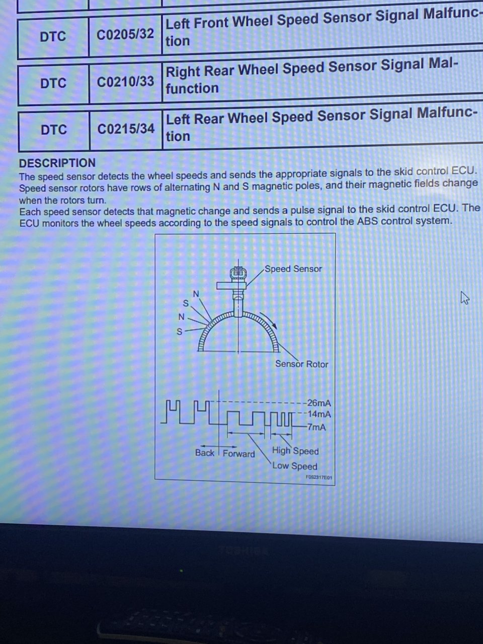

    You need an oscilloscope to test the sensors. The signal is a 7-14ma current that’s monitored.They aren’t like the traditional inductive sensors that send ac voltages.
    Your best step would be verify the trouble condition described by the code.

    I know, I’m telling you the procedure to test these is to monitor current(amerpage). You will always get an open or some crazy high megaohm. These are active sensors. They require voltage 12vdc to be turned on. I have not found the inner circuit diagram but I’m guessing transistor controlled.
    They are back probed while installed and use of a scope to verify this wave form in mA. (Current) not voltage.
