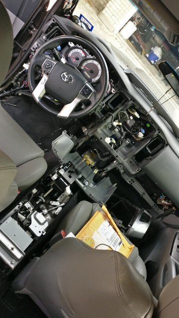

    I have a 2006 Tacoma (SR5) that both the cigarette lighter socket and the 12V power socket to the right must be worn out, as I typically cannot get my plug-in USB adapters for my phone to work. It seems to be getting power, as the charger will occasionally work if I wiggle or shift it around until it finds the magic spot. The same thing happens if I use different plug-in USB adapters as well.
    Anyhow, I was considering removing the cigarette lighter socket and replacing it with a hard wired round dual USB port. The port requires a threaded nut to secure it in place from the back. Does anyone know how to remove the center trim piece I highlighted in the photo or an easy way to get access to the back of the cigarette lighter socket, or do I have to take like half of the dash apart?

    Whole center dash has to come out. Sounds daunting but it’s not. Tons of videos on YouTube if you look for stereo installs.

    And FWIW, what the guy in the write up you linked did is maybe the safer way but all that plastic around the steering wheel doesn’t need to come out. Loosen that one upside down plastic fastener on the right side of the wheel and there’s enough give to pull out the center dash surround bezel.

    As for the instrument cluster bezel, yeah, that’s the way I did it when I swapped in the ‘12-‘15 lower dash panel into my ‘06.

    I would find it much easier to pull the cig socket out and clean/inspect the unit, replace, or tap wires to the cig connector to install some usb ports. You can remove that storage cubby compartment by prying it up and out. That might give you a little access to the back of the cig.

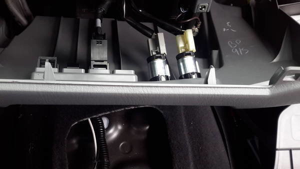

    So here's the back of the panel in a '14. (I don't have anything earlier) the 12v outlet it clipped to the bezel and then clipped to the power source. So if you were able to jam your daughters hand down there and bypass the sharp plastic edges, then somehow blindly release each piece... I would be amazed lol.
    Honestly, taking apart the trim is your best and safest bet. Super easy.

    Dealer had to warranty replace the cigarette lighter socket on my 2014 when the cover broke off. They told me if you use a dental pick and press the appropriate tabs it will come out. I believe them because they replaced it in 20 minutes. Before that I was under the impression the dash had to come off which had me worried since I had lots of custom wiring run behind it.

    Dental pick! That's what it was. :thumbsup:
