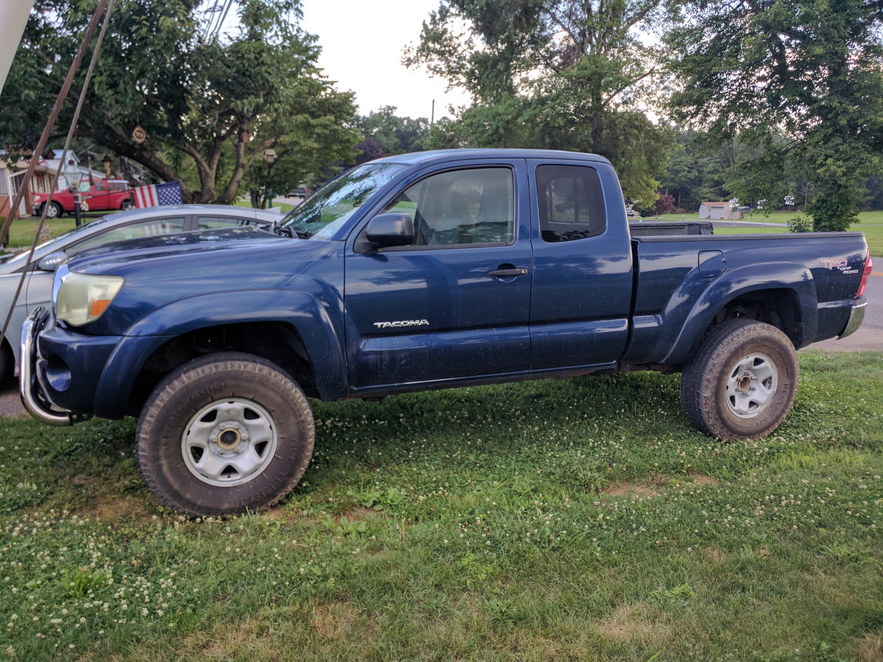

    here is some measurements from the center of the hub to the fender.
    front is approximately 24"
    rear is approximately 25"

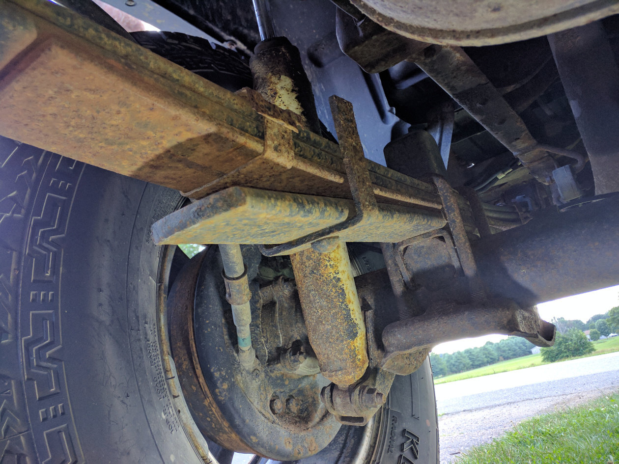

    I have attached some pictures of the front and rear passenger side suspension.

    Based on what I see I don’t see anything indicating a lift. Maybe higher rate coils were installed at some point but everything looks pretty vintage as well. I agree it does seem to sit a little higher than what I’d expect to see from stock. No block in rear but maybe a single add a leaf in the back?

    Looks stock underneath to me too. .... and it looks like it has a lift.

    ^^^^^ this. There is no lift on that truck per say.

    The rear looks to have a cracked 3rd leaf one way or another, whether it's a factory/TSB 3+1 or a 2+1 with a single AAL that cracked. You can run the VIN and see if it maybe has the leaf spring recall still outstanding.

    Given these numbers, I would say the OP has a lift especially to run 285s without rubbing. Likely unknown coilovers and the rear pack has been replaced or an aal added because 05 tacomas came with a 3 leaf pack, not 4. Regardless, you have rusted worn components and leaky shocks which will have to be replaced anyways.

    Front coils are 100% thicc probs a better spring rate, that third leaf in the pack is indeed a 2” AAL, the leaf is squared at the end, cheap add a leafs come like that.
