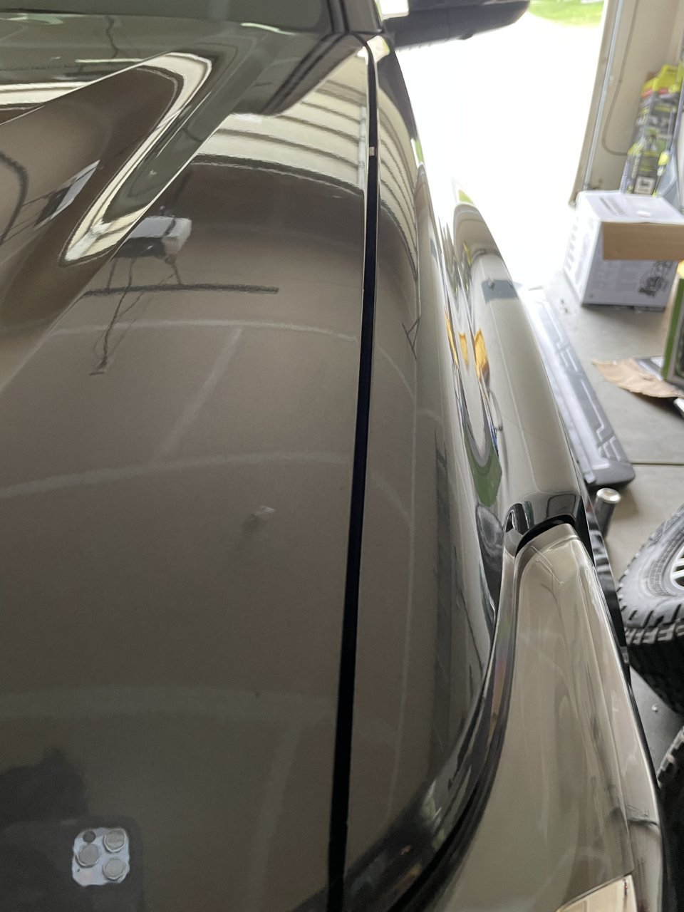

    Hi all,
    I recently removed and replaced my hood and I’ve noticed an increased gap on the driver side vs. the passenger side that wasn’t there before. From what I’ve researched most people have issues with the up/down alignment that’s adjusted with the rubber stopper.
    Is there an easy way to adjust the side to side alignment of the hood? It doesn’t appear that the 4 bolts on the hinges allow for much adjustment but perhaps I reinstalled them at an incorrect angle?
    Below are some pics - you can see the the rubber piece in the channels of the hood are more prominent on the driver side vs passenger side. Any insight would help!
    6446C3E6-A643-4B82-935B-7234762C9483.jpg F383FEA4-8EE5-45FF-9547-FEE495ABE0C1.jpg 9E3B7C53-1CEC-401F-8C69-61FAE5824183.jpg
  2. Sep 27, 2021 at 3:53 PM
    DNguyen1033
    DNguyen1033 Well-Known Member
    Jun 15, 2021
    #368682
    369
    Nguyen
    Southern California
    07 OR | 21 OR 4X4
    The 2 bolt on each side should auto align the hood. Did you get an aftermarket hood? Maybe that’s why? I’ve swap hood and install ditch light bracket before and both hood auto align perfectly.

    Only thing I can think of is, tighten by hand (fingers), close hood not all the way, align, lift up and tighten 1 bolt, close hood not all the way, adjust, Repeat until evenly align? Then tighten all bolt?

    I found this :
    http://www.ttguide.net/adjustment-1827.html
    which is exactly what I’m trying to do but it says the replace the centering bolts with standard bolts…no idea if this means I can’t adjust the hood with the hardware that came with it or not
  6. Sep 27, 2021 at 4:22 PM
    DNguyen1033
    Jun 15, 2021
    #368682
    369
    Nguyen
    Southern California
    07 OR | 21 OR 4X4
    What it mean is, get a standard bolt (bring one to Home Depot and match it) and manually adjust it like I mention above. The bolt that come with it auto center ur hood but it’s off for what ever reason. I can tell u it’s gonna be a pain in the rear doing this lol.

    I've removed my share of hoods and before I loosen any fastener I mark the area around the brackets with tape so I can reposition the bracket in it's original spot. Since you don't have that luxury tighten the fasteners enough so you can still move the front of the hood left to right with out losing the position. I also place foam between the fender and the hood to keep both gaps even to help with alignment. If you don't have foam or something non marring you can use cardboard as shims. Good luck

    The issue I’m running into is the hinge that the bolts go through to secure the hood allow ZERO movement even with the bolts extremely loose. There’s a few millimeters of forward or backward movement but no give from side to side

    Good to hear. If there is no other adjustment what I have done is to physically force the alignment to center the hood. I have never done any hood work on my Tacoma but on past trucks I had to resort to that as a last effort.Can't say why yours is not going back to stock alignment.

    Is one bolt holes on hinge oblong?

    One thing I may mention here, the hood gap may be just fine?
    Is it possible the hood is in the same position as the old one except now you are really seeing the gaps close up for the first time due to the switch?
    Not saying your case, but I cannot tell you how many people I dealt with over the years at body shops who said something was not right on their car after repaired when it was. Especially full frame vehicles since the tolerances for gaps is not the same as unibody. I would compare their vehicle to brand new, practically measure gaps and they still fight and say it was wrong.
    Maybe check a few other trucks to see what they look like.
    Just a thought.

    It’s certainly possible, I will admit that I looked more closely after reinstalling the hood. The only thing that makes me question it is the rubber stopper thing on the inside channel is far more visible which I’m sure I would have noticed before and according to the service manual it’s way out of the clearance standards. The gap is almost 5mm+ in some areas….unless I’m misunderstanding how it’s supposed to be measured?3F7E1974-2B37-4490-A3FF-AD5F5A5D078C.jpg
