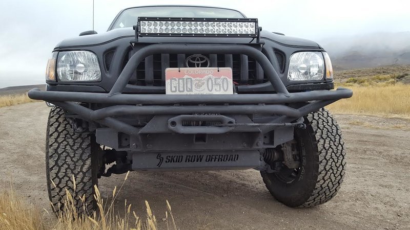

    Donahue racing lift kit, TG low profile bumper, TG rock sliders, Skid Row skid plates, and currently building.
    This is the TG low profile bumper with light bar. I was concerned about how a winch would fit, and the 10k trail gear winch required cutting some of the grill. I installed all three skid row skid plates and am very happy. I removed the rear seat and built a chest with draws and top side hinged lids. I also installed dual batteries and am in process of building an auxiliary fuel cell between rear wheel wells not to rise above or extend pass them. I will be measuring tomorrow but estimated close to 30 gallons. I have an extra leaf now but will probably go with Deaver 10 pack. I understand truck should sit properly and support 600 to 800 pounds load. I know CB radios are on way out, but one fits very well in ash tray slot. If interested in additional lights, consider Black Oak. I have the 20 inch bar up front offering 22k lumens and two pods in the rear providing I think 1320 each.

    icon stage 10 kit, toytec 1" bl, 35" general x3s, 17x9.5 procomp wheels, locker anytime mod, s&b intake, blackhawk 2.1 tune,
    As an opinionated asshole on the Internet i am forced to say that the placement of that lightbar bothers me on a deep level.

    Only if I roll lol it, I have many miles back country hunting and it be fine, but I understand. It is the side panels that get ripped in to lol because of the narrow passages thru the forest. It can take weeks to cut thru with a chain saw lol.

    It would look better inside the light hoop. But hey, it's your set up. If that's how you like it then F everyone else. That light bar doesn't look like it would fit inside the hoop anyways. I have mine on top of my TG low pro bumper. I really want to relocate it somewhere else. I don't like how mine sticks up & blocks my grill.

    It would look better within the light bar, and it does look terrible, but the winch was difficult, otherwise i would have fabricated something to center it properly; if I wire the winch differently, I will do so. The only good aside from awful looks, is it works really well lol. I am sure you too appreciate the light your two light bars provide. I have a light pod mounted behind cab above bed on each side for a rear view.
