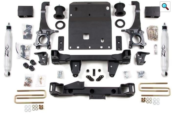

    Drop bracket lifts require you cut the cross member so you will need that piece and a welder.

    the drop bracket requires you to cut the stock cross member so you can mount the front diff lower. you will have to weld a that piece of cross member back in to lower or return it to stock height. you have stock upper and lower control arms. you would need stock rear shocks, stock front spindles and stock length u-bolts. Maybe stock sway bar end links I can't tell if those are stock or not

    Wont be selling the truck, I have around 8k into the engine alone lol Is the cross member a part of the frame? The shop I went through does strictly bolt on's, I doubt anything was cut. Can you tell based on the picture of the kit?

    You literally can’t install a 6” drop bracket lift without cutting the crossmember that is part of the frame.

    Its doable just a pita...as @mynewtoy stated the parts you will need.
    Rear shocks
    Ubolts
    Cross member and welder to put the member back
    Stock front spindles
    Maybe sway bar parts.
