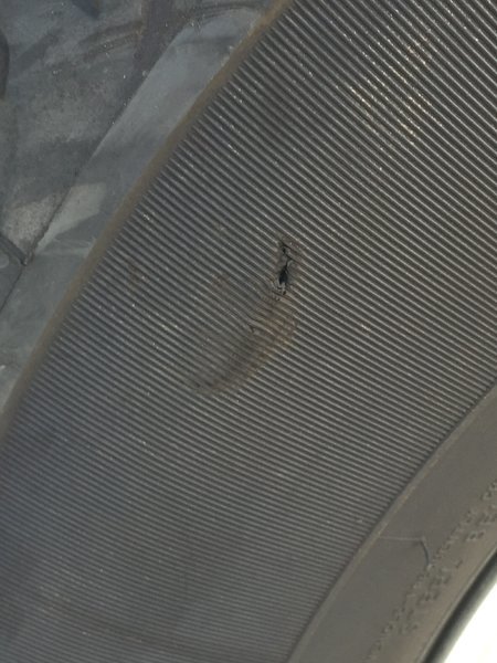

    Hi All,
    Just noticed a hole in the sidewall of my tire and I'm pretty sure I'm going to need to replace it.
    Anyways that being said I'm sure I'll have to buy 2 new tires right?
    If the shop recommends 4 should I or no?
    I have 16k miles on the tires and they still have a lot of tread.
    Also can you recommend a good tire store!
    Thanks

    Does the tire spare match? If so, have them put that on and then just get a cheaper one for your spare.

    Awesome idea.
    Will that be okay with the difference in wear?

    Do you have a locker or LSD? If so make sure that both those tires on that axle have the same amount of wear or close on them and be the same size (only an issue if you spare is undersized). Rotate the spare to one of the front tires. As far as new tires go, I am a Discount tire fan. Their warranty would have covered that hole and they would have given you a new tire. Maybe something to look into when your old set wears out.

    I have LSD yes so in that case I will need to replace 2 tires?

    It would be ideal for them to have the same level of wear. I would rotate the front tires to the rear, put the good rear tire and the spare on the front, and get a new spare. That would suffice for now. Then if you need a new tire down the road replace two or all of them. Unless you really want new tires now, then go for it.

    Worst case scenario you replace two at most. You don't want a brand new tire on one side and a worn tire on the other. But with 16k miles on your tires I can't imagine they are that far gone.
    Definitely replace the damaged tire. But definitely do not buy 4 new ones to fix one.

    If your considering the factory button to electronically lock the diff as a LSD dont let the new tire on the rear bother you. I did this very thing when I put a hole in my sidewall- I had the spare mounted onto the aluminum rim and away I went. Zero issues. Now I may or may not have taken the opportunity to use the super charger to resize that tire to match the other 3 after a month or so....:burnrubber:

    Is this a proper hole all the way through or is it just a cosmetic gouge that doesn't go through the sidewall plies? P rated or C or E?

    No idea on the rating whatever comes stock on a Sport.
    When I got home I put a tooth pick in it and it barely went it.
    I think it's just cosmetic

    Looks pretty deep to me. I would not trust that tire on the highway at all. None.

    I would use the spare. That is exactly was I did when I had a cut on a tire on my 2009. As long as there is no air leaking from the hole then use that tire as a spare. The cut on my sidewall was about 2". Discount balked at putting it on the spare rim. I just told them that I had been driving on it like that for months and could just take my business elsewhere. In 7 years I have never had a spare on the ground.
