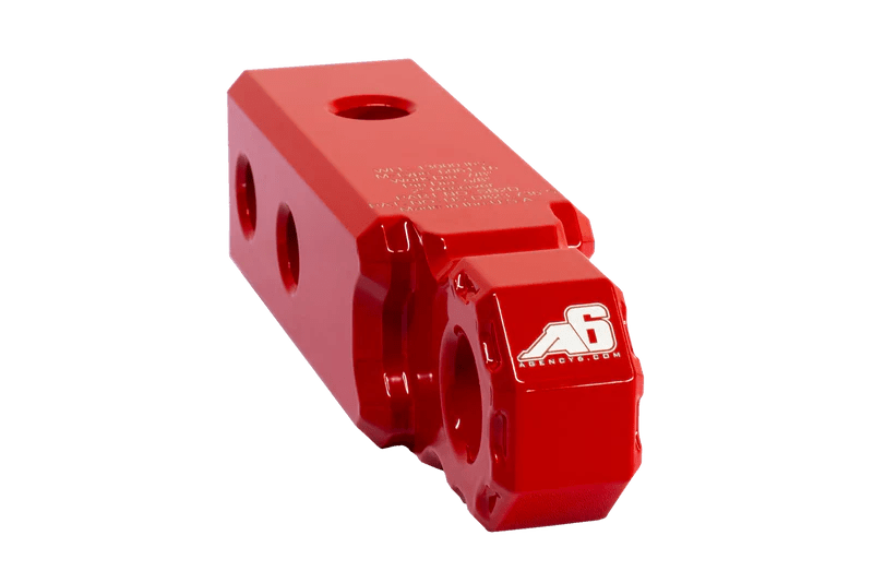

    I bought this one. No issues with it.
    That said, if you don't mind paying a little more for an US made product, these seem decent
    https://agency6.com/collections/shackle-blocks

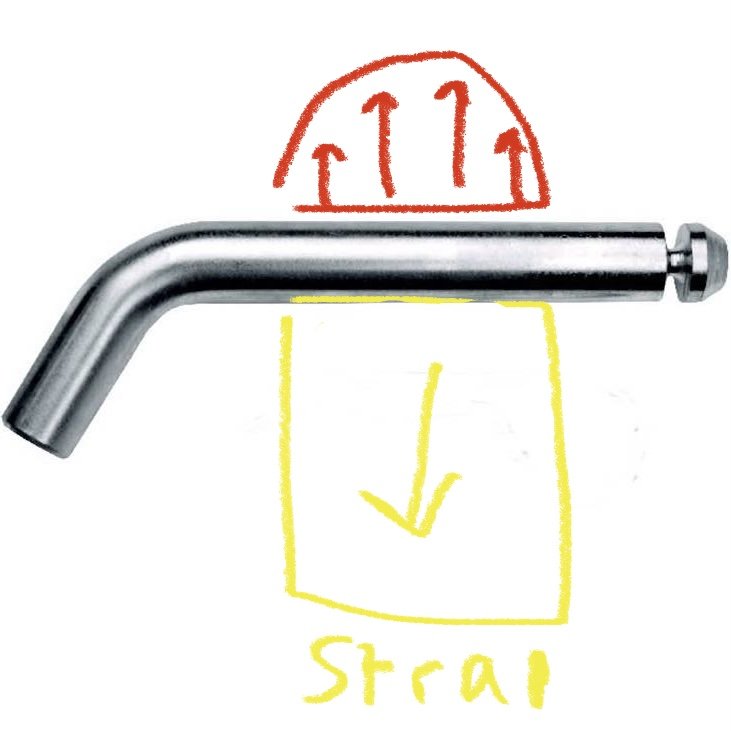

    Don’t do this if you can avoid it! It puts a bending load instead of a shear load (which is what hitch pins are designed for) on the pin and can bend the pin and get it stuck in the receiver. It sucks to have to sawzall the hardened steel pin out.
    In a real pinch/emergency I’d do it as a last option but wouldn’t have it be my standard operating procedure.

    That appears to put the pin in shear just like a tow bar. It’s doing the same thing as an accessory installed in the receiver - supporting the length of the pin inside the receiver so that it is applying 2 shear forces to the pin instead of 1 bending load along the whole length.
    The strap is soft so it applies a distributed force (in red) along the pin and can bend it.
    With a proper draw bar or accessory installed the pin is supported along its length inside the receiver tube so only 2 shear forces are applied at the interface between the draw bar and receiver tube.

    That was my thoughts as well, just not near as technical as you ;)
    So with that being said, would you ever feel safe using one? Or would you resort to the shackle system.

    I wouldn't hesitate to run the soft shackle hitch eyelet you posted. As far as the hitch pin is concerned it'll see the exact same forces it would with a hitch draw bar or Dring Shackle mount installed. No reason to worry about bending the pin with that setup, looks good to go to me.
