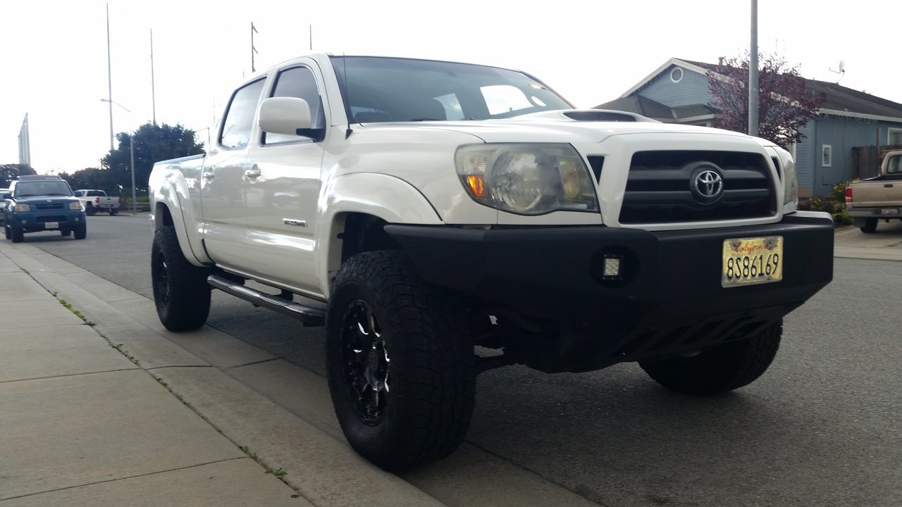

    Who is the manufacture of this bumper? It fits your truck Perfect!!

    @Mobtown Offroad

    I’d like to think we make them pretty strong. The wrecked truck is from a guy hitting a cow going about the same speed you were going. Here is a little write up from him: https://www.instagram.com/p/CHO6pKyH9WM/?igshid=1o9ybnm502odh
    Also, we are running our Black November Sale which can save you up to 20%. Here is a link for the hybrid bumper that is ever so popular for the second gens. We sell plate bumpers too.
    https://mobtownoffroad.com/product/2005-2015-toyota-tacoma-front-hybrid-bumper-w-grill-hoop/
