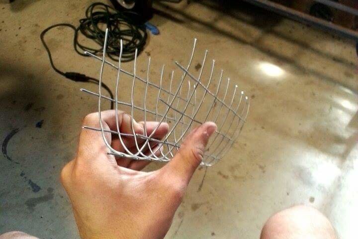

    I fixed it! My snorkel tube no longer sucks shut on full throttle acceleration. Here's what I did.
    I found this wire in my garage -
    I cut a section of this wire fencing out and folded it in my hand like this -
    I trimmed off one of the edges because it was too long, then I slid it into the tube like this-
    I put it all back together and tested it 3 times full throttle accelerations. No problems anymore! I'm thinking I could have lined all of the hose with this wire instead of cutting the corner out. But, I already did it so this is all the rubber hose I have left. Hope this helps anyone who might be unsure about doing this project or anyone who was having the same issues as me.

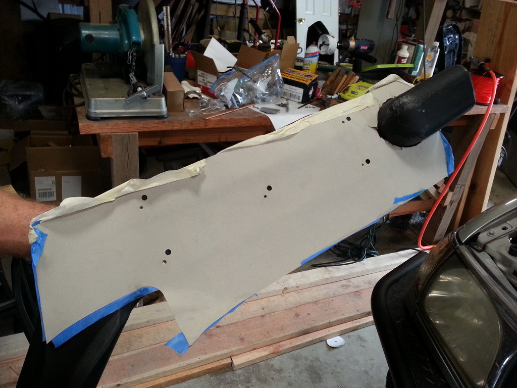

    Any chance you have a picture of the snorkel like this but without that piece of paper attached?

    Hmm, not sure. I can look for you. I think I posted all the pictures I took though
