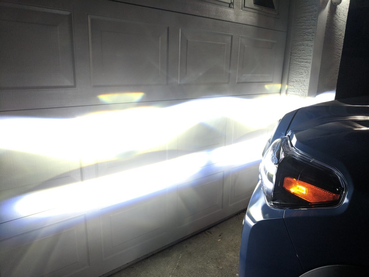

    Here is a wall shot of the H4 version (right), against my brighter than stock halogens (left). People claim the 'new' H11 one is better.
