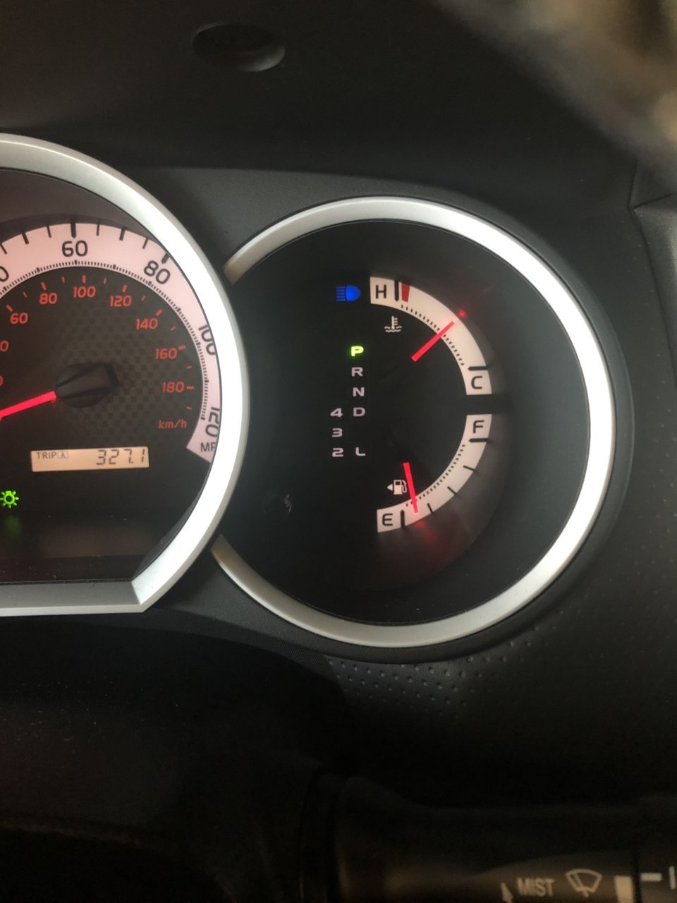

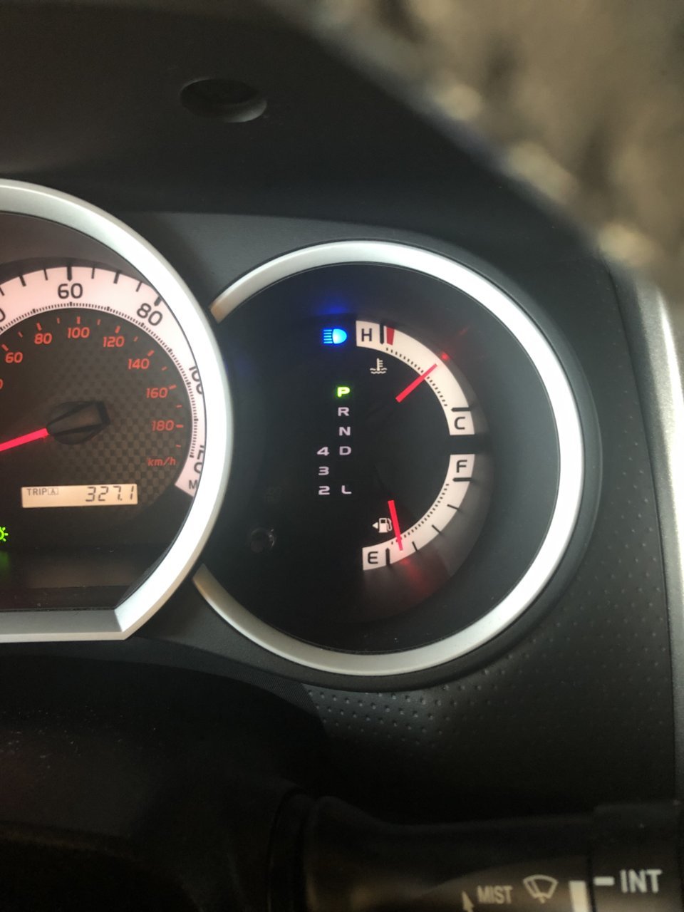

    It just rained here recently in SoCal and I noticed that after the storm had passed, the high beam indicator on my dash would turn on whenever I turn my headlights on even though my high beams are off which has never happened before. However, when I do turn my high beams on, the indicator on the dash would turn on of course, but just brighter like how it was before.
    Has this happened to anyone and if so, were you able to fix it? Thanks in advanced
    Headlights on but high beam off
    Headlights and high beam on

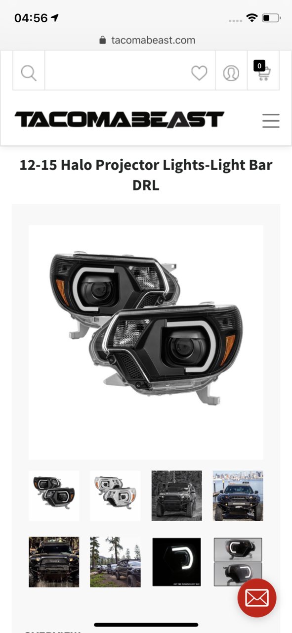

    I installed a set of these Spyder headlights back in March as well as a set of Beamtech LED bulbs
