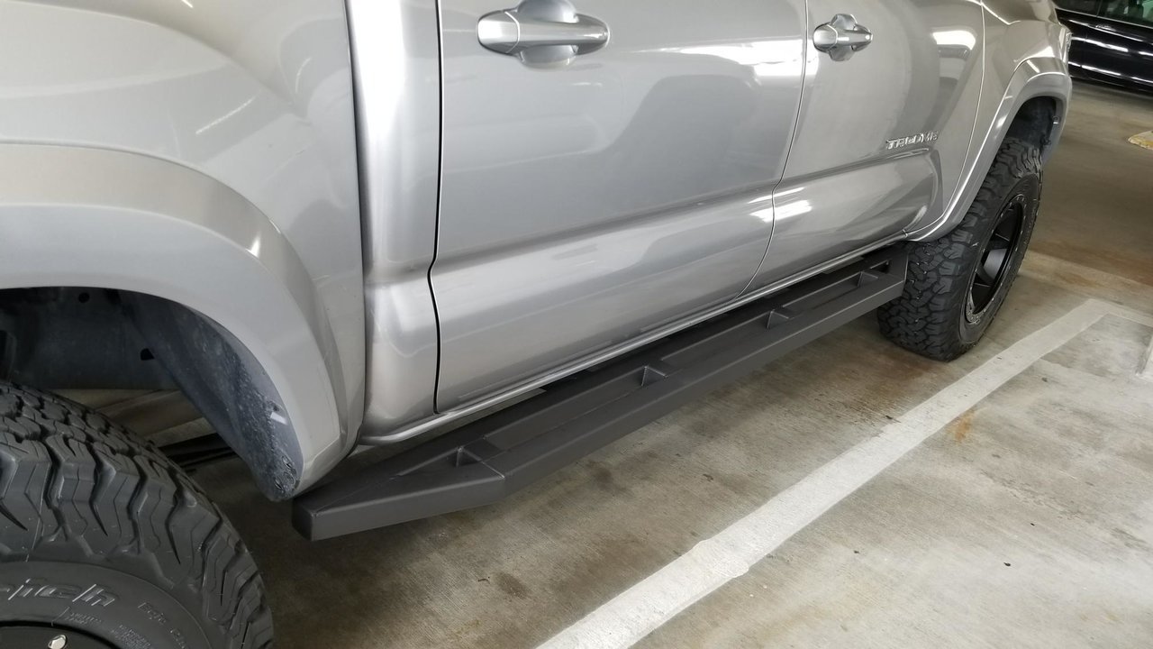

    My victory 4x4 sliders are some of the cleanest sliders I've seen that still offer full under body protection and moderate rocker panel/door area protection: IMG_20180221_111825.jpg
