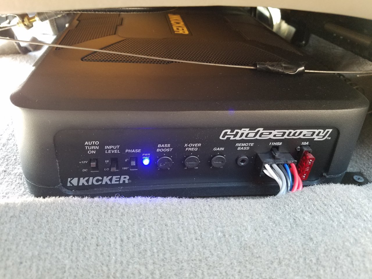

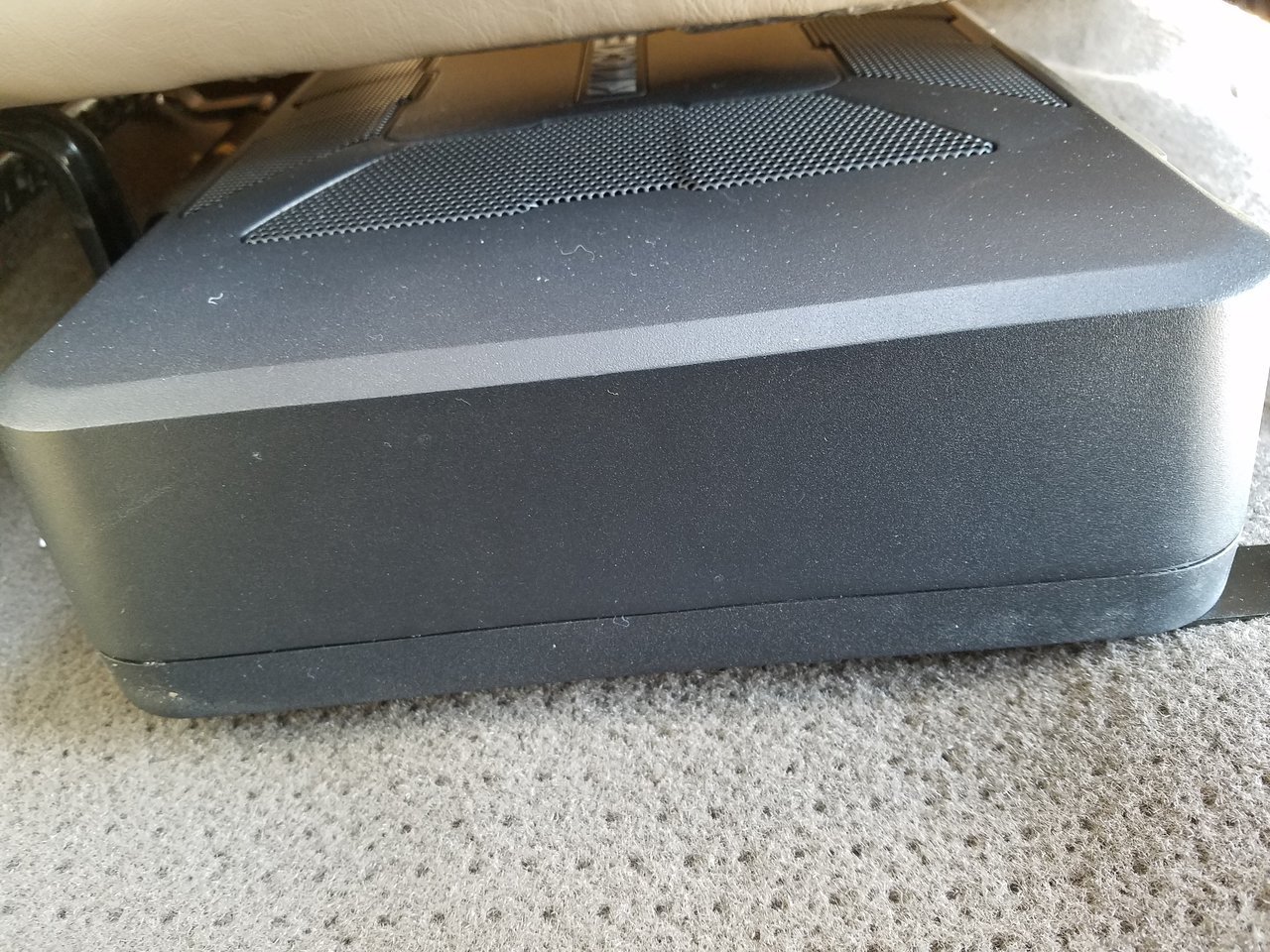

    Just got the install done. This thing fits right under the passenger seat. You wouldn't even know it was there.
    My honest opinion is that this thing is PERFECT for an Xtra cab truck like mine. It sounds amazing and even hits a lot harder than I thought.
    You can hook this up two different ways. I chose to get the RCA adapter and hook into my Kenwood HU for control. I think this is the cleaner and better sounding option.

    After some adjustments in my truck with the sound, I appreciate this little sub even more! I would say for a single cab or xtra cab, this is MORE than enough. This would even sound great in a double cab.
    I only have the gain set at about half on the HU and sub. It bumps pretty good. I can only imagine what it would sound like at full gain!

    The infinity should be just as good. I also changed my door speakers and tweeters. I wen't with Alpine all the way around, with a 200 watt Alpine amp. I didn't use sound dampening material, except for one spot on both sides of the front doors. The speakers were causing the casing to rattle with the plastic material behind them. Easy fix.
    I screwed the sub down under the seat. You can actually see it in the pics. I wanted to ensure they were secure, in case of some serious bumpage. It came out great.
