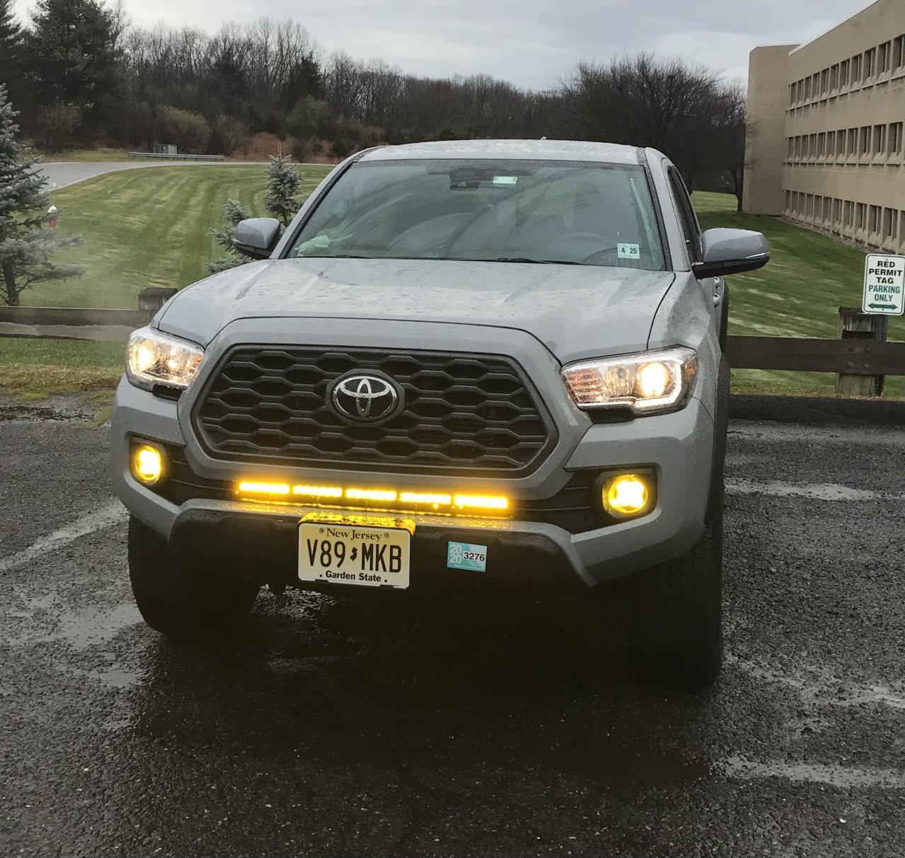

    EF922B94-DC7B-40BD-8A8E-C85BBD58BBAE.jpg I used the Diode dynamics kit and removed the deflectors for the install and was able to get them back in without any cutting. Did the install in warmer weather so deflectors were more flexible.

    The amber looks good!
