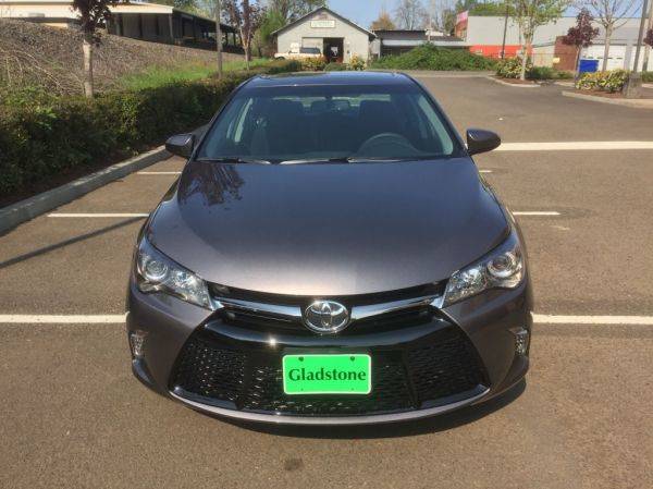

    My new Camry has halogen projectors. I know that I can put HID bulbs in the stock halogen projectors. My question is, should I?
    I know that putting HID bulbs into a traditional, non-projector, headlight housing is bad news and that it essentially blinds everyone else. Does the same thing happen when you put an HID bulb in a halogen projector?
    I've seen pictures and comments on the interwebs that show/say its okay to do because projectors have the cutoff line, which prevents blinding other drivers. Light output and distribution seems to be good as well. But I've also seen pictures and comments where people have done it and there's a semi-cutoff line with glare above this poor cutoff line and so-so light distribution. Does the quality of HID bulb have anything to do with these mixed results I'm seeing with these stock projectors?
    I was on The Retrofit Source's website and I found a review where someone put HID bulbs into his 2015 Camry's stock halogen projectors. (Here, sixth review down) They said the cutoff was "laser-like" and it had "really uniform light distribution." So now I'm thinking either A) they're exaggerating and blinding other drivers; or B) Sweet! It works, I won't blind anyone, and I'll be able to see tiny bugs on the road at night!
    Does anyone with experience with this type of thing have any input/answers for me?
    If you've put HID bulbs in halogen projectors, it would be really nice if you could share some pictures of how it turned out. To get you started, here's a picture of my new Camry.

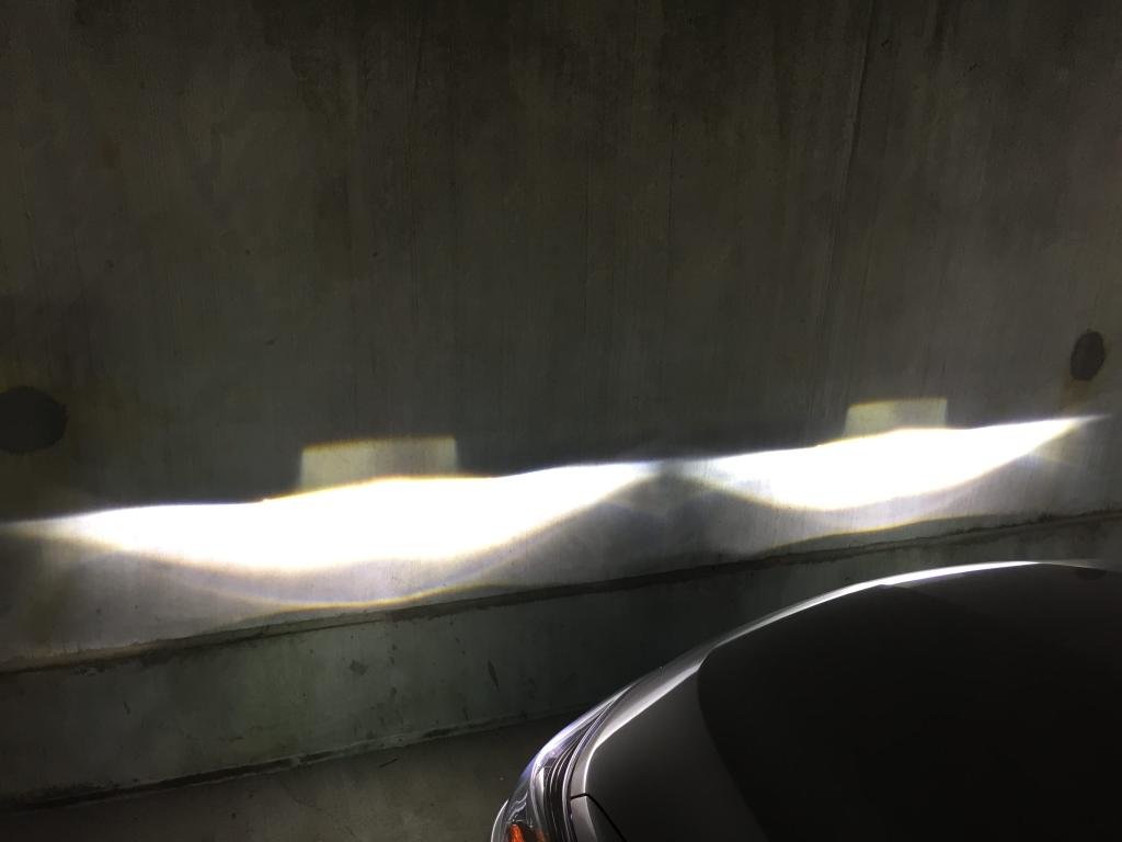

    So you're saying I could do these non-afs and keep my stock high beams, or do these bi-xenon and ditch my stock high beams. Right? Or would the bi-xenons work at the same time as my stock high beams? I'm assuming the bi-xenons, while in high beam mode, are about the same as the stock high beams? Or are they brighter than the stock high beams? Thanks again for the info.
    I kept looking around and actually found some definitive answers on what would happen if I put HIDs in my stock halogen projectors. I found someone that did what I was thinking of doing, plus a bunch of other lighting stuff, in a 2015 Camry. Here's a picture of how his beam pattern looks with HID bulbs inside a stock halogen projector.
    Not too shabby right? However, those two rectangles on top of the cutoff line are the "squirrel finders" TRSAndrew mentioned a few posts up. Those rectangles are what is going to annoy other drivers. Not as bad as HIDs in a non-projector halogen housing, but they'll still get people.
    So I think as soon as my wallet lets me, I'll go ahead with some TRS HID projectors and bulbs.

    Not too shabby indeed! I'd be interested in seeing what the cutoff looks like from a distance. The rectangular area looks pretty dim. Doubt it'd be much of an issue. Did they elaborate on that where you found that pic?
    Your best bet is still to do a proper retro. Are you gonna use your original housings? I'd imagine they're in pretty good shape..

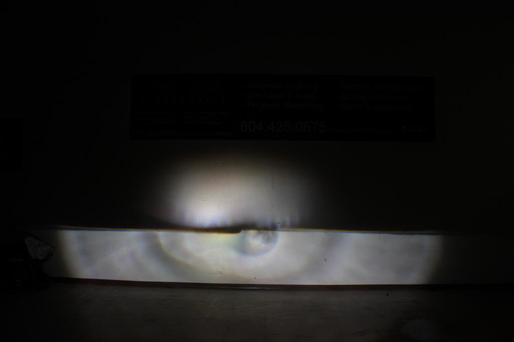

    And before anyone posts saying that looks horrible.. Compare that to these spyder halogen projectors with hids inserted;)

    The beam on those spyders you posted is horrible. I've always heard to stay away from aftermarket HID assemblies, but I didn't know they were THAT bad. Thanks for showing me that picture. Now I know I'll never go that route with any vehicle.
