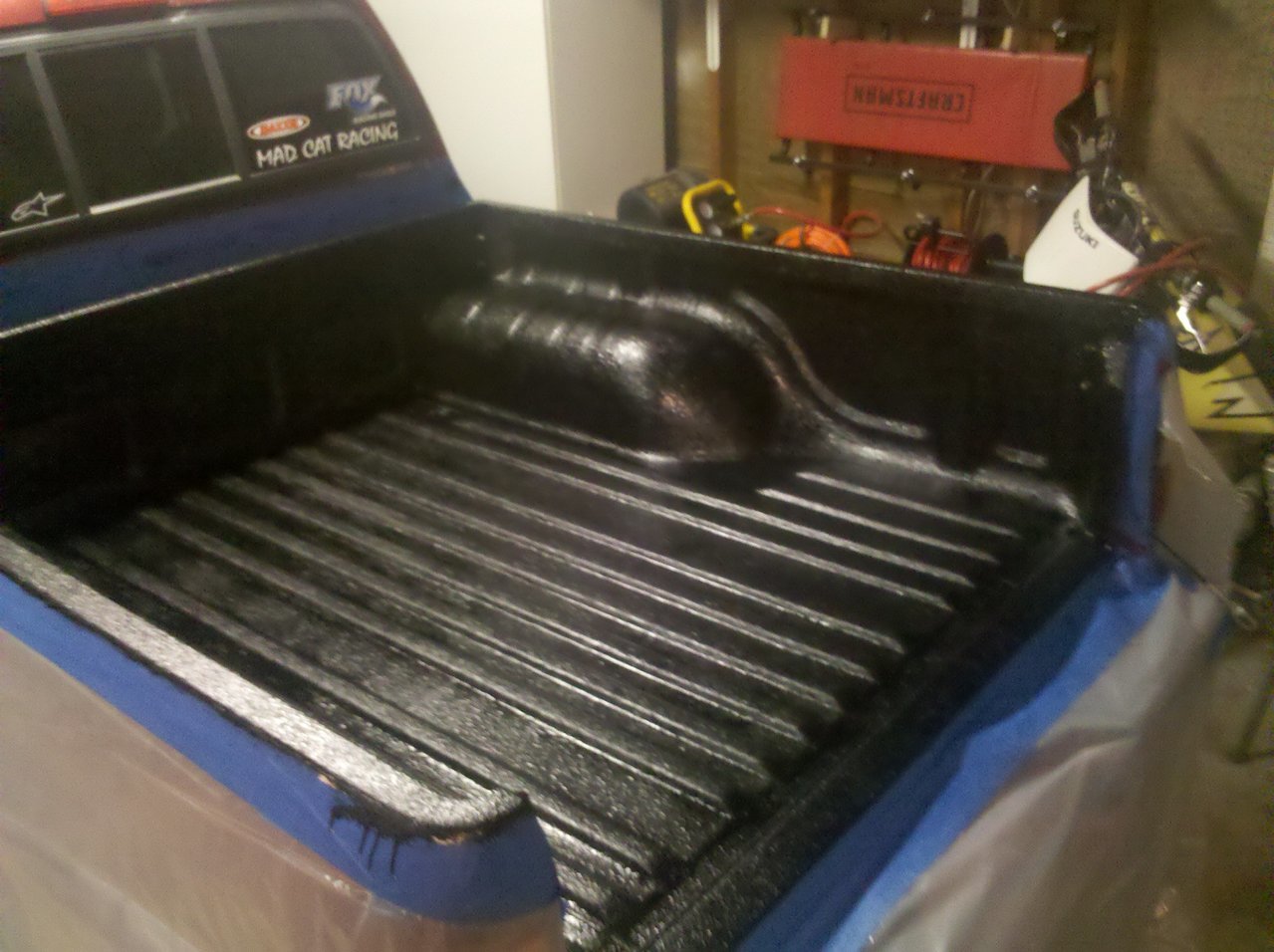

  15. Apr 18, 2018 at 12:56 PM
    austinsdad99
    austinsdad99 [OP] Well-Known Member
    May 30, 2017
    #220261
    511
    1999 prerunner 3.4
    As promised just got 1 for now has not dried and tailgate still off but turned out well.

  16. Apr 18, 2018 at 1:51 PM
    #16
    lucky13don
    lucky13don Well-Known Member
    Mar 29, 2017
    #214798
    5,410
    Don
    Milton, fl
    R.I.P.04 tacoma prerunner, 04 sequoia 4x4
    Too many to list
    Looking good...how many coats you gonna do?
  17. Apr 18, 2018 at 2:17 PM
    #17
    austinsdad99
    May 30, 2017
    #220261
    511
    1999 prerunner 3.4
  18. Apr 18, 2018 at 2:21 PM
    #18
    lucky13don
    Mar 29, 2017
    #214798
    5,410
    Don
    Milton, fl
    Too many to list
    I was gonna try for 3 when I do mine..yours is looking good.:thumbsup:
    austinsdad99[OP] likes this.
