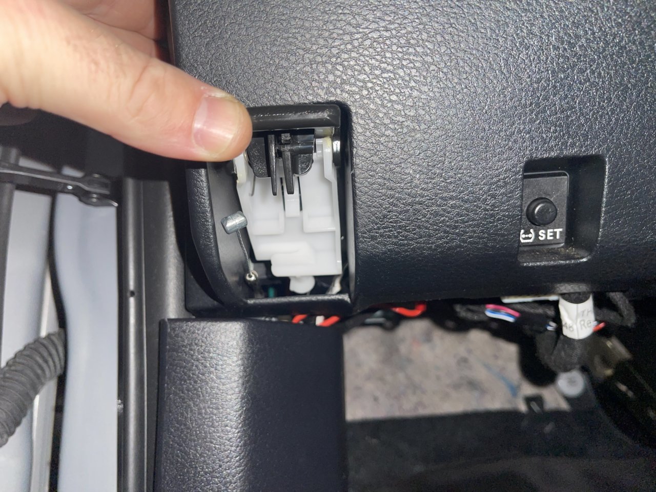

    Installed s-Pod BantamX today, Somehow when I was pulling the Cat 5 through the firewall I pushed my cable out of the latch, And I just can’t seem to figure out how it slides back in, would anyone happen to have a photo? I can only find videos of the second GEN, But that latch is different.

    I think...

    I disconnected mine so I could pull the whole panel for a stereo install. It was a major pain in the ass to reconnect it.
    From what I remember, you have to work the panel from both sides, so undo those screws and pull the lower dash. Feed the cable through, attach the end tip first, then attach the cable sleeve second. Then reattach the lower dash panel.

    Well I can get it back in the handle but it won’t stay, the cable housing seems like it should be anchored down somewhere

    I think there is a notch in the housing, right where the cable enters... that notch should clip into the white plastic clip.

    It might make it easier if you can pop the hood... taking tension off of the cable, giving it more slack. Although that may be difficult or impossible with the cable disconnected from the latch.

    Here's the FSM procedure

    Just like Saturday nights, just pull the ball and it opens right up. I've futzed with mine plenty of times, it's a right pita to get back in the latch but not impossible

    That was it, exactly. Thank you, all fixed. Tricky lil thing
