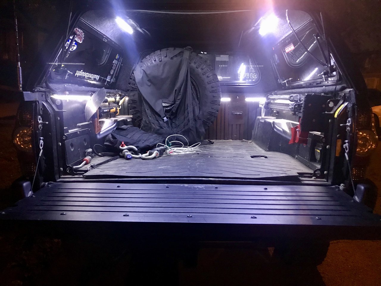

    For me, and I am sure others, the light that came with the shell is absolutely worthless; it's not bright at all, the truck has to be running for it to work.
    I wired my own system that runs off the battery and a switch in the cab that works if the truck is on or off:

    @geekhouse23, thanks, what brand/ size of lights did you end up adding in? looks like a far better option than stashing a headlamp in the corner of the bed

    https://www.amazon.com/gp/product/B00UI1DVP2/ref=oh_aui_detailpage_o00_s01?ie=UTF8&psc=1
    I used two; one around the bed under the rail the whole way around and then cut and solder strips for the roof.

    How'd you attach them to the headliner carpet? Thanks.

    Flat aluminum stock that is 3" wide. Drilled holes into the aluminum on both sides; one side to ziptie the rope lights to and the other side to bolt to the topper using the Thule trailer that run the length of the topper.

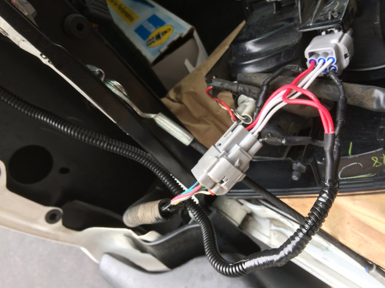

    I didn't want to tap into the OEM wiring so I purchased a trailer wiring harness from etrailer.com, and spliced into that to wire my brake light.
    https://www.etrailer.com/Custom-Fit...Tacoma/2014/118496.html?vehicleid=20141176461
    The harness plugs inline between the OEM taillight connectors (only one side needed for the taillight), making it simple to return to stock if needed. I added a quick-disconnect fitting in the bed so the wiring can be easily disconnected when I remove the shell. You'll want a multimeter or test light to determine which wires are ground and hot with brakes applied.
