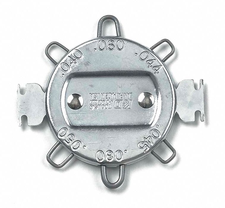

    I just got a set of NGK BKR5EKB-11 from rockauto. All the plugs came with a gap of .020-.030 so I was starting to think I got the wrong plugs since the gap was way off.
    Anyone know how to gap these things without breaking the center electrode? All I have is one of those disc shaped gap checkers.

  20. Jul 19, 2017 at 1:48 PM
    #20
    ThunderOne
    ThunderOne Well-Known Member
    May 20, 2009
    #17473
    10,042
    Mitchell
    Nashville
    1ST GEN OR GTFO
    Toyota NERD
    Trapperr likes this.
