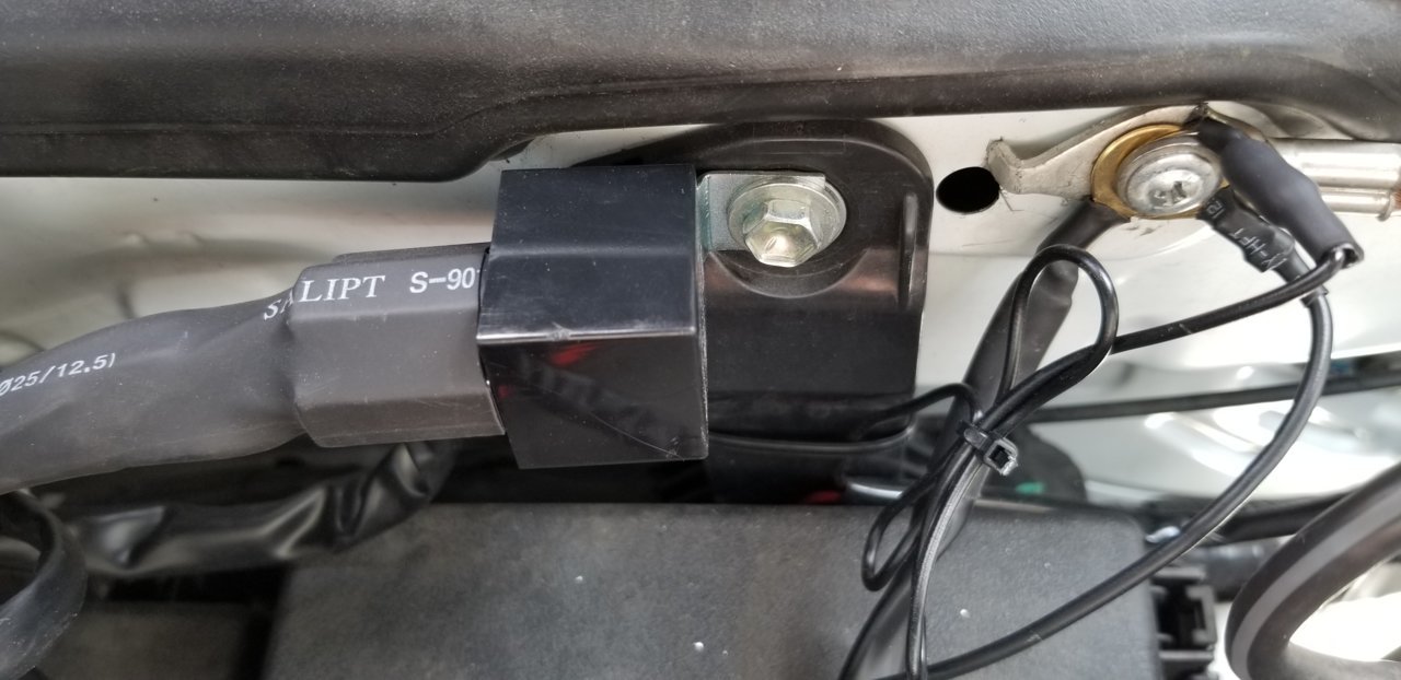

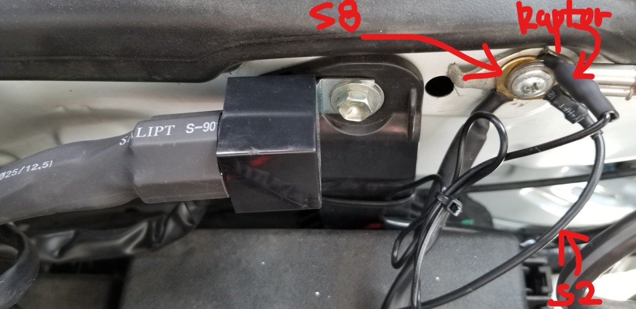

    The ground is attached to the bolt next to the relay.
    The S2's I have installed as ditch light works fine with caliraised OEM switch.

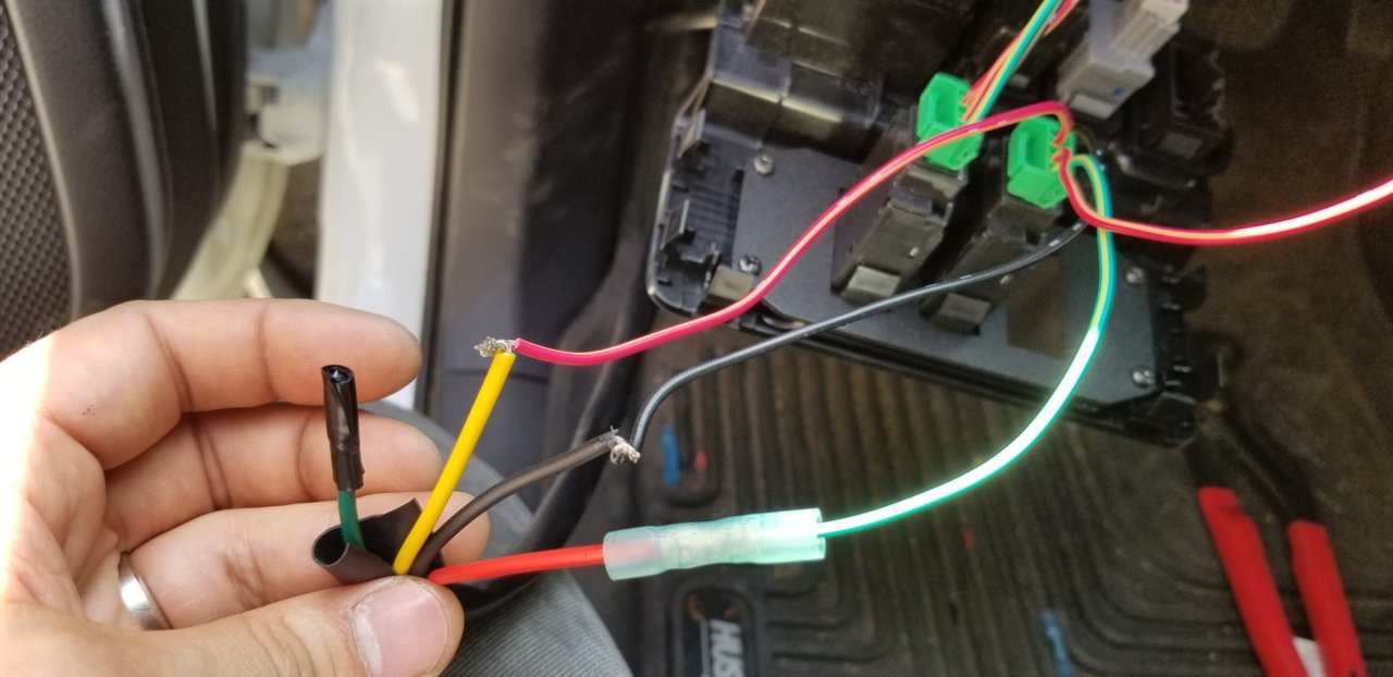

  15. Jun 20, 2021 at 1:59 PM
    ThisIsCovy
    ThisIsCovy Well-Known Member
    Feb 25, 2021
    #357395
    136
    Covy
    Phoenix, AZ
    2020 Tacoma TRD Sport 4x4 DCSB
    Do you have any photos of this work? I'd love to do the same. Im constantly forgetting to turn the backlights on my S8 off when i lock the truck. lol
