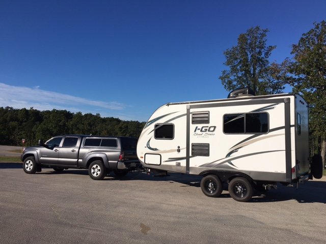

    I tow this camper and I have the tow package on my truck. The camper box is only 15 feet long with an overall length of 19.5 feet. It weighs 3200 from the factory but with the stuff added (AC, Gas Bottles, etc.) it weighs 3600. We travel lite so I figure we are at 4200lbs. I did add a larger tranny cooler, brake controller (Prodigy 3), a set of 2K Hellwigs helpers, and a scanguage II to monitor tranny temps. I do know it is there when I tow. It shifts a lot between 3rd and 4th (don't tow in 5th)

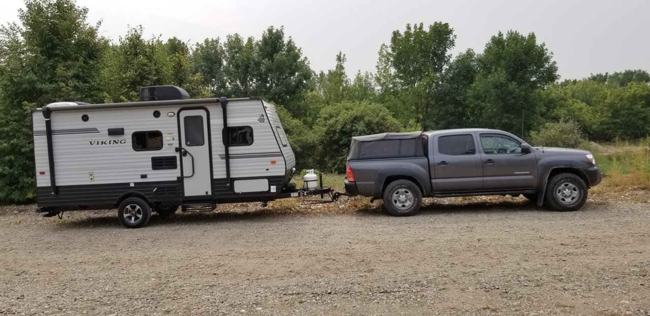

    I pull this trailer without a tow package. It weighs 2900lbs dry. I had the seven pin wiring harness installed along with a brake controller. I use a weight distribution hitch and a sway controller. I have the V6 with a manual. For that reason my truck wouldn't have had the trans cooler, so essentially all I was missing from a tow package equipped truck is a larger alternator and an auxiliary engine oil cooler. As someone above said, nothing that comes in the tow package will make it safer to pull a trailer. I think you'll be fine pulling that trailer.
