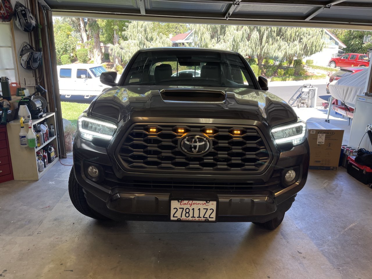

    F8A5D191-BEA7-4DCB-8A79-92B3FE0EBDCA.jpg F8A5D191-BEA7-4DCB-8A79-92B3FE0EBDCA.jpg
    Replaced the headlights on my toyota tacoma but the bumper isn’t lining up any more. Any one else has dealt with this and can help me?

    Sorry for the format but looking for help on how to realign the bumper properly.

    It's the black plastic piece that probably fell down and you put the screw in without it standing up.

    It’s there. I made sure it was still there before putting the bolt in. I heard 2 clips snap in place when pushing it back in. Any other suggestions?

    Is it broken and you didn't notice? That's really the only thing I remember that would cause that. Maybe @no vtec 4me could help.

    I think I might of figured it out… I pushed the black bracket down to the front of the car when putting the bolt it and i think it grabbed the bumper a little better. I also noticed that the 10mm bolt in the wheel well when tighten to much flares that tip of the bumper out. Still open to any suggestions anyone might have. Definitely made a difference what I did but not to sure.

    That black bumper to fender clip has 3 tabs on top that “click” in place. It’s held on by the 10 for the headlight (check if the bolt is actually going through the plastic or if it’s completely broken making that bolt only holding the headlight and not the black guide clip and headlight) and a red push pin (the 4 sided tabs that hold the clip also break easily unless you release from the backside)
    Pictures are easier to explain- you can see the dealer busted the plastic that the headlight bolt is supposed to sandwich in place. If it’s broken it will flop and not be high enough/tight enough to the fender as you tighten the headlight. Or maybe you just need to loosen and hold the guide up tight to fender as you tighten it back up. And you can see the tab broken for the red pin but I doubt this alone will cause the guide to sag
    CAFF7035-E2B8-4B96-9351-4893F92EF8B2.jpg 3F5C3C4E-ECBD-4F22-B752-63EF4769C259.jpg 8C58A1F4-A0A4-4235-9379-E19372B699AF.jpg
    Here you can see the temp fix I did with a washer to help sandwich the remaining material left. Tabs marked that secure bumper
    bbburwell[OP] likes this.

    Wow! Thank you so much for giving me all that info, best help i’ve seen so far. Yes the bolt is in correctly and the black tabs aren’t broken. I’ve take the bumper off and on now like 20 times and only here 2 clicks (tabs locking in place). Should there be 3??
    I’ve found that you really need to crank the 10mm bolt from the tabs to the headlight tight.

    The third is behind the fender.
    The angle of your photo sucks- looks like it’s tight near flare but not headlight, almost like something is causing it to protrude… near the front bottom of the headlight. I don’t think there’s tabs there but isn’t there guide like ribs that more/less “hook” at the bottom of the headlight
