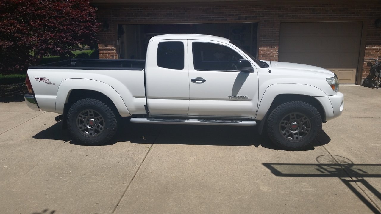

    Obligatory new wheels (Graphite TRD Pros) with new tires (Goodyear Wrangler UltraTerrain AT, 265/70/17) pic:
