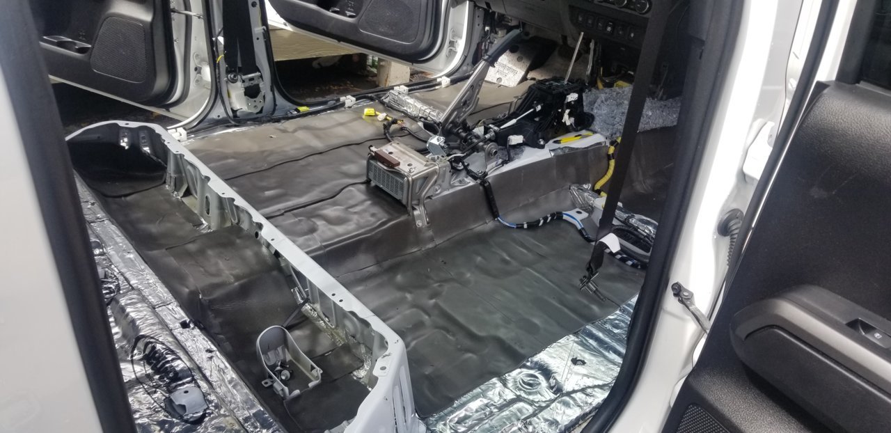

    Did noico sound deadening and noico closed cell foam insulation on floor, backwall, and all the doors. I can definitely tell a difference in winter with temperature and it's amazing how quiet it is.

    that 1 piece or 2 different layers?

    2 different pieces and layers. The silver sheets are the sound deadening the black sheets are the closed cell foam insulation. The picture is halfway through the process. I covered everything 100%. Some people would say it's overkill but I was looking to get more thermal insulation opposed to just sound deadening.

    I'm looking to do the same, is it much quieter on the road?
    What brands of mat did you use?
    And approximately how many sqft of each did you need?

    Yes it is quieter. Used about 2 boxes of noico 80 mil sound deadening and 2 boxes of noico red 150mil closed cell foam.
    Noico Red 150 mil (4mm) 36 sqft (3.4 sqm) Noico Liner Car Heat and Sound Insulation,Heat and Cool Liner, Self-Adhesive Closed Cell Foam (PE Foam) https://www.amazon.com/dp/B07TKXMPH7
    Noico 80 mil (2 mm) 36 sqft (3.4 sqm) car Sound deadening mat, Butyl Automotive Sound Deadener, Audio Noise Insulation and dampening https://www.amazon.com/dp/B00URUIKAK
