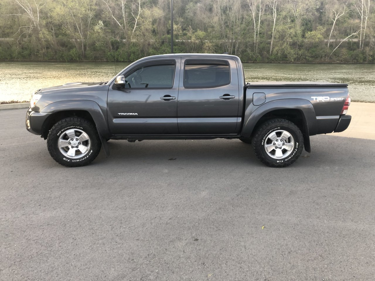

    Long story short.... I bought an MGM truck..... I thought.
    I buy an MGM 1G3 grill from eBay and it didn’t match.....
    first pic.
    then I buy another MGM grill from a member and install it today only to find it doesn’t match either.
    second and third pics
    so how dumb am I? What is going on?!
    door tag last pic

    Do the surrounds you bought match each other? It almost looks like the plastic tab bits below the headlights match pretty well, but the bumper doesn't. Hard to tell thru the computer screen.
    Paint fades over time. Also wonder if that bumper was ever repainted.

    1G3 is your color. Toyota's VIN tag is not a liar. Unless you are a professional autobody painter you probably wouldn't be aware of variances.
    Let me break this down. The manufacturer uses one supplier for its paint material, then the other manufacturers then need to match that formula. Each manufacturer sources their own base materials that will come as close as possible to emulating the original.
    So, one supplier uses product 'x' to make their color, and the other supplier uses 'y'. There is where the issue arises. Most companies will try to copy the original formula, they might be off slightly. They make a variant of this to try and develop a better match. This then happens with the other paint manufacturers and suddenly the same code is available with any number of variances from each manufacturer.
    It would seem to me that either somebody mixed the color a bit off, or just used a prime variant and the part went out the door like that. Either way the 'grey' of your body IS 1g3. The grille looks either desert sand, or a light pyrite mica. Unless you can live with it like that it will need painted to be a better match to your vehicle.

    I stopped in to the body shop to have my MGM grill shell color matched with the truck when I got rid of the chrome grill. There’s about a dozen MGM color variants. The body shop owner said MGM is a very challenging color to match. Mine’s not quite as off as yours but it’s certainly different. I left it as is.

    1st picture looks like pyrite mica. 2nd picture looks like the SR grill, it's a gray color that is only used for the grill.

    That grille looks more like pyrite mica than mgm

    I agree with above, first photo is pyrite mica second is the SR grille. You’re getting sent the wrong grille. This is why I didn’t want to chance it with eBay, I just ordered from my dealer. You want PN:5310004481B1. I believe I paid $180 for the entire assembly.
