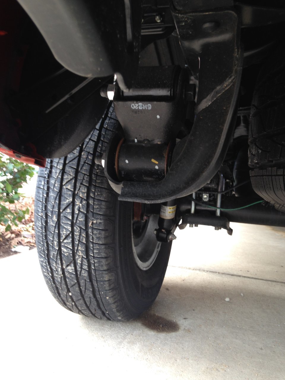

    Hello all! I've noticed an oil spot on my driveway ever since I took my truck in for Toyota Care maintenance a few months back. They changed the oil and filter as well as the other scheduled stuff.
    Here's a pic of the spot in relation to the under area:
    Here's a pic of a component covered with wet "oil":
    When I put my finger to the wet areas, it feels oily and smells like mineral oil or motor oil and seems to be clear.
    Any thoughts of what this could be? I'd like to get a general idea of what it could be before taking the truck in.
    Thanks in advance for any help/suggestions/overall consulting on this matter.

    Looks like a shock issue or a wheel cylinder

    Looks like a failed/leaking Shock .

    Looks like your shock is leaking

    Are you sure it has a motor oil smell? I'd have guessed brake fluid or gear oil back there.
    Gear lube you'd know, it's very distinct.
    ETA: Leaking shock makes sense, too.

    What would cause a leaking shock on a relatively new car?

    leaking shock...

    It could be, it's just that I'm not sure what brake fluid smells like.

    Cold weather can make the seals go bad. Once they heat back up and cool down rapidly can cause cracking.

    Doesn't really. It's nasty, so wipe a little in your eye and tell us if it burns really bad or perhaps you lose vision.

    Open the hood then Open up your bake fluid and stick your nose init

    just a manufacturing error , bad luck . etc. Lucky for you it happened under warranty and not after .

    Leaking shock. Cold weather + big pothole = blown shock. Or, just a bad one from the factory...

    Dirt on the shock shaft nicks a seal and then it starts leaking.
    Usually if you see a leak start looking up. Keep going up and when you don't see any more evidence of leaking you have found the source. I'll bet money there's nothing on the top of the upper shock mount...leak is at the shaft-seal.
    Most likely the shock. Buy Bilstein 5100's, get a pair. They ride better anyway.
