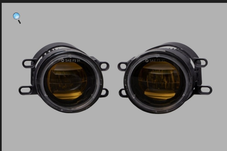

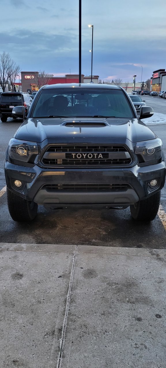

    I have a set of 3000k Diode Dynamics Elite Series Fog Lights on order. They are backordered right now. I've been going back and forth between the white and the yellow. I think the white may look better/match my setup better. But I know the yellow would perform better in rain/fog/snow.
    I'm running Diode Dyanmic HP24 switchback LED signals that match my halos. They are white and switch to amber on the signals.
